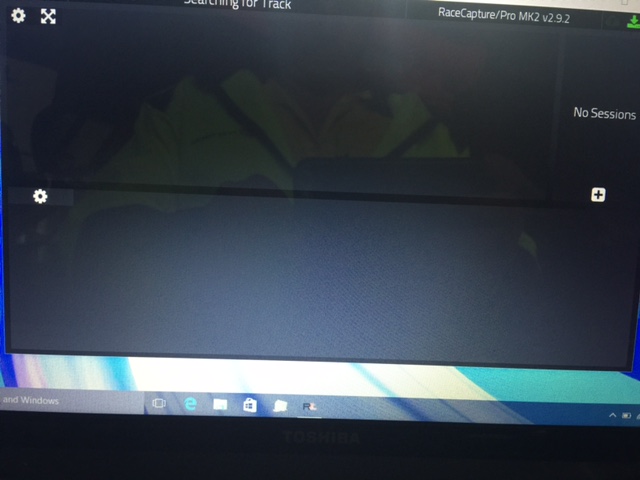

Thanks Ryan,
that pic looks like its in the analysis tab of the app. At the moment after logging my analysis section only shows 'no sessions'. Does the app only show 'laps' after I have passed through GPS coordinates manually set for the start & finish lines?
(its hard for us to test this as we can only run on the track during designated race days & the boat can't be run on local waterways due to registration & noise restrictions)

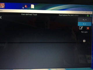

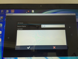

No Probs,
So I've managed to download some of the log files (shown in the pics) but they won't open. Do I need to log while doing laps - using the start & finish gps coordinates I have entered manually, & then view the files?
Sorry for the 100 questions but its hard for us to test this as we can only run the boat on race days due to rego & noise restrictions in our local waterways.

Yes, right now in order to view the logged data you need laps. The data is still logged, the app doesn't have a method to view the data by time instead of by lap. Luckily we have a release that should be out today or tomorrow that adds this functionality.
Right now you can open the file up in Excel or Numbers, it's just plain CSV, so you can view the data that way.
