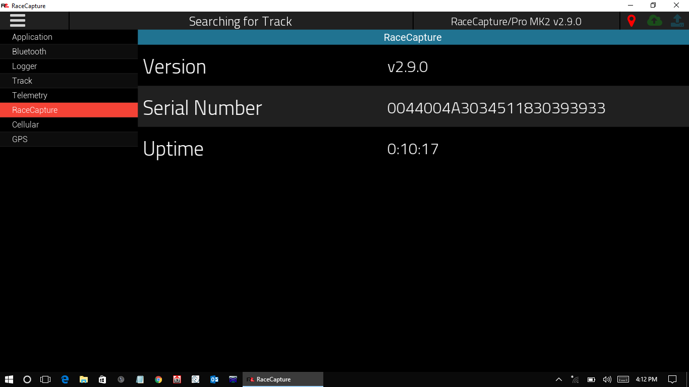

Still kicking my butt
The box firmware is 2.78 and I'm having trouple getting it to take the latest firmware. I keep getting failure to initialize boot loader. I hope to have better luck tomorrow. I tried the instructions that come up onscreen
01. disconnect 12 v
02. disconnect usb to RCP2
03. wait 3 sec
04. hold down button and reconnect usb.
I'll read the text file in the firmware folder and see if I have better luck with that tomorrow.
Anyways, here is the log file:

Getting Closer
Well I finally got the update to take. To anyone else reading this. I would suggest making sure your version of RCP software is updated to the latest version. Now the "How to" screen grab shots make sense. So I am using the latest version of RCP on a Windows 10 tablet. Here is the code that you requested:
[lua] Gracefully stopping Lua Task
[lua] Destroying Lua State
[lua] Initializing Lua state
[lua] memory usage: 16KB
[lua] Starting Lua Task
[lua] Loading script. Length: 21
[lua] Successfully loaded script.
*** Start! ***
CAN0 init @ 500000 win
CAN1 init @ 500000 win
Start OBD2 task
BT: Detecting baud rate...
BT: Baudrate: 115200
IMU: init res=0
timebase/logging/telemetry sample rate: 50/25/25
GPS: provisioning attempt
GPS: probing baud rate: 921600
GPS: module detected at: 921600
GPS: detected current update rate: 50
GPS: Configuring update rate to 10: win
GPS: Configuring NMEA messages: BT: Device responds at baud 115200
BT: Init complete
fail
GPS: Error: could not configure NMEA messages

- I've included a frame grab of the SN too.
- 2.png (44.3 KiB) Viewed 21752 times

Do you have the cellular module option with two antenna connections on the front? Sometime we've seen cases where people accidentally connect GPS on the top connector, but GPS actually needs to be connected to the bottom connector.
Did you ever get a GPS lock on this unit with any firmware version?

Hey Brent,brentp wrote:Hi,
Mine only has 1 antenna port located next to the left of Error/PWR lights. When I got it back from USB port repair, I was not able to get GPS signal till I did a 2.72 to 2.10 firmware update. I was using Solostorm on phone via BT and RCP on Win 10 laptop via USB to check the GPS signal. The next day I was hoping to finally play with the Wifi module and 2 GoPros but I was back to no GPS signal.
I tried to replicate the success by going back to 2.72 and upgrading to 2.10 but no joy. I swear the RCP MK 2 box is laughing at me.
Tane
- Posts: 22
- Joined: Mon Apr 13, 2015 4:01 am
- Location: Orlando
- Contact:
Yes, after the USB repair I only got GPS lock once after going to 2.10.0.brentp wrote:Thanks.
So under a clear sky and 2.10.0 - you only got a GPS lock once then?
Since your GPS module is initializing, but not getting a signal, there could be a problem with the antenna, the module itself our the GPS chip's RF front-end.
Did it work reliably before you got the USB repaired?
That is the confusing thing Brent. Maybe a random mph creep every now and then when at the starting line. That is the only odd thing I can think of. The box has been stable and tracking has been spot on and in sync w gopro footage.
I'm game to order another antenna. Is there a way I can test the antenna cable?
Tane
The GPS creep can happen as the GPS locks on and satellites are acquired, then it will stabilize. GPS is an incredibly complex process, presented in a simple way. The key metrics for quality are the GPSQual, GPSSats, and GPSDOP indictors.
For GPSQual you want 2 or 3 for best performance; GPSSats - 8-11 satellites; GPSDOP - smaller number = better (DOP = Dilution of Precision)
You can get an antenna on Amazon for relatively inexpensively, just ensure they have a SMA connector.
Let us know from additional testing; happy to take a look at the unit directly again too. Just let us know.
