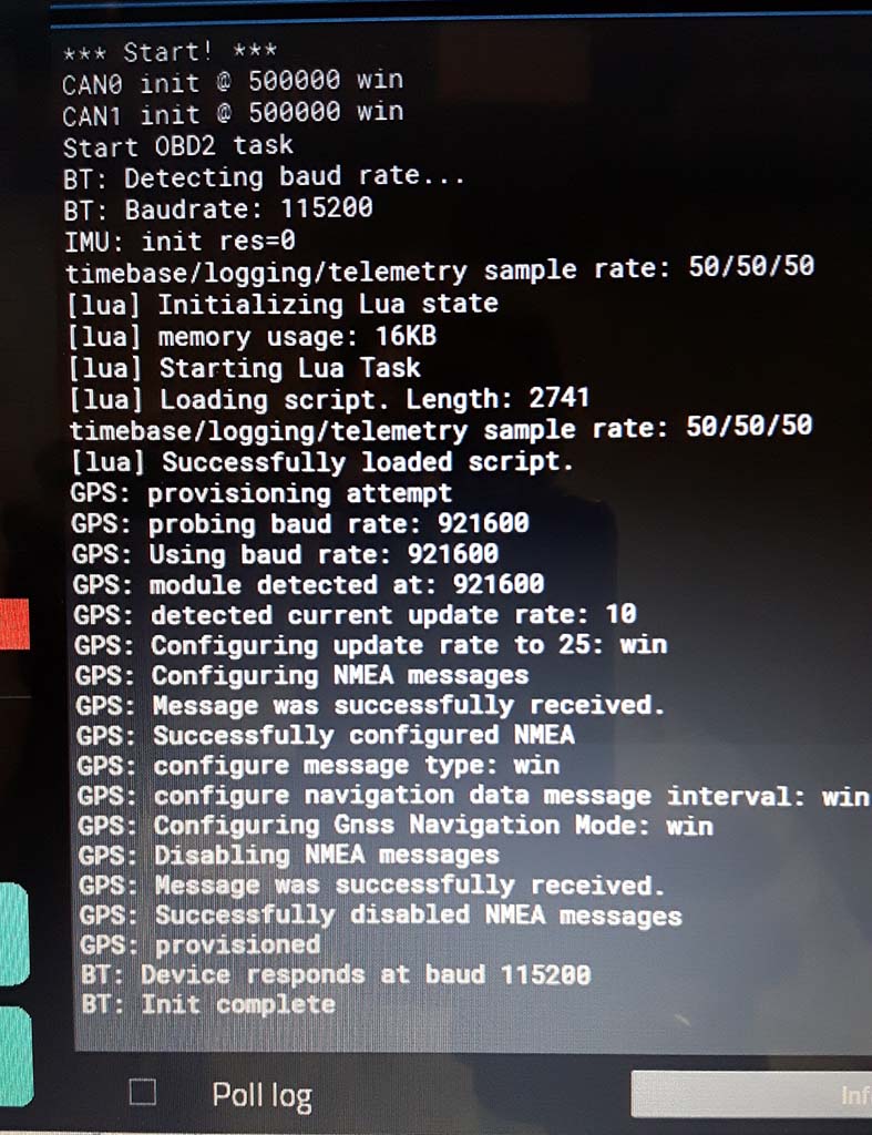

With your bluetooth module, can you paste the unit's log file when you first power up the unit? We'll be looking for messages related to bluetooth initialization.
also, can you create a simple script that reproduces your scripting problem on 2.10.0 so we can test over here?

brentp wrote:Hi,
When I paste the log into Windows Notepad, I only get Chinese characters, so here's a photo of the screen. One thing that might be interesting is that my friend's bluetooth module is larger and made more recently than mine.
