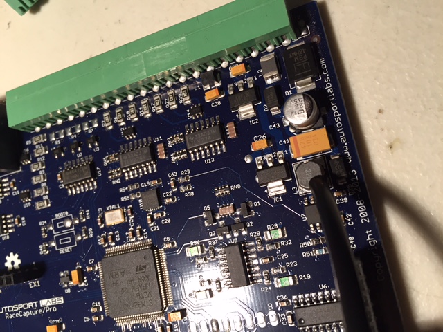

I opened it up to see if I can see and damaged components or see if anything is shorted and drawing to much current.
The only suspect component is the L3 inductor (pic attached ). It gets pretty hot. The voltage regulators are all cool to the touch.

pic attached (where the black tube is pointing at)

Correction, it is the IC U7 right bellow it that seems to be the issue.
It is on FIRE. I'm pretty sure it's shorted. Could you please provide the part number so I can order a replacement and swap it out?

Yes, it is a FAN8303 - easily obtainable as you've found.
Question, did you recently have a low battery condition where you needed to jump the battery, or any alternator faults?
The issue is either the chip went bad, as you suggested, or there's another short downstream. If you remove the chip and supply *regulated / current limited* 5v to the board (on the striped side of C41) that will provide a hint.

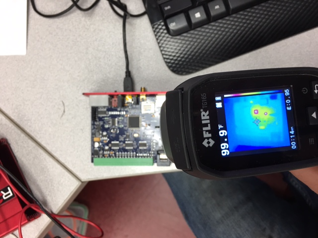

I finally got around to replacing the FAN803. But it did not solve my problem.
When I plug in the USB I get no COM activity at all on the device manager tool.
I used an thermal imaging camera on it to see if anything looked unusually hot. The micro controller gets pretty warm (120F or so), but the U8 IC below it is on FIRE. I can't get a temp reading on it since it's too small but it's significantly hotter than the micro controller.
Any advice on what to try next in troubleshooting/repair of this board?
