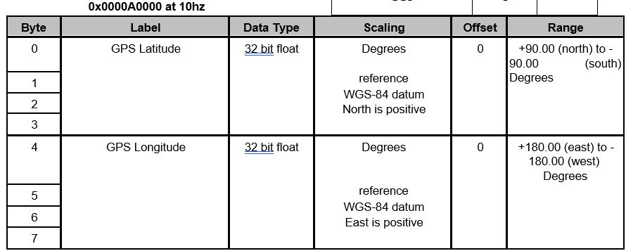

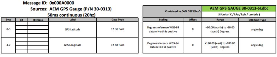

The script below is verified to send Racecapture Pro2 Canbus data to an AEM Infinity 506 to simulate an AEM Vehicle Dynamics Module. The only channels that are not transmitted are:
latitude (unsure how to send a 32 bit message)
longitude (again unsure how to send a 32 bit message)
GPSTrueCouse (don't believe RCP has this channel to send)
With all the other data logged by the AEM Infinity I can now create Maths Channels with AEM data!!

Didn't verify it but can you try the following:
lowlat = bit.band(lat,0xFF)
midlat = bit.band(bit.rshift(lat,8),0xFF)
highlat = bit.band(bit.rshift(lat,16),0xFF)
higherlat = bit.rshift(lat,24)
Please come back with the outcome of this!

Made some more progress on splitting Longitude into individual bytes by using code above. This data is to be transmitted to my AEM Infinity ECU. I think my issue is I don't know how to create the conversion to 32 bit float with degree referencing. Please see extract from AEMnet pdf. Anyone got any ideas?
- Capture.JPG (42.49 KiB) Viewed 9984 times
I realize this is an ancient thread -- did you ever figure this out?fitdes wrote:Made some more progress on splitting Longitude into individual bytes by using code above. This data is to be transmitted to my AEM Infinity ECU. I think my issue is I don't know how to create the conversion to 32 bit float with degree referencing. Please see extract from AEMnet pdf. Anyone got any ideas?
I'm trying to transmit GPS data to an AEM CD7 dash, although I don't need to adhere to their (AEM) protocol.
I will need to send signed values, though.
It should work fine. Here's a script we have used to simulate SmartyCam data from our early testing, should get you started: https://gist.github.com/brentpicasso/0c ... e80c86694c
