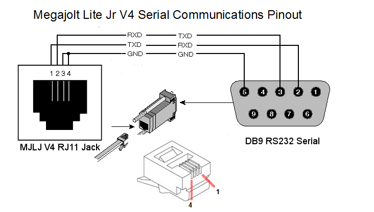

Have my megajolt all hooked up and cant get it to communicate with the laptop.
The edis runs fine. But obviously stuck at 10degrees.
Ive tried a usb to serial converter with proper drivers installed and connecting to the computers serial port with a extention harness as the megajolt cable isnt deep enough.
According to the schematic for the adapter i should have had continuity from pin 5 to 3 and 4
I only had 3 so i went and modified the phone line to bridge 3 and 4
But a timeout message still comes up.
And i am trying to find the proper com but cant with the serial port as nothing says its connected. While the usb adapter itself does show up.

I saw your note; the cable we provide only requires 3 wires, it's not necessary to bridge the connections.
