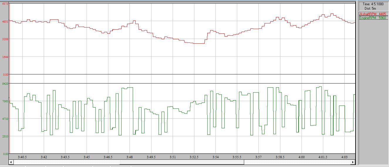

yeah - the signal must be changing as the RPMs pickup and drop. I'll see if I can find a scope, if not i'll have to keep testing other inputs off the engine to try to find something that will work.
(attachment shows the data from the hall effect sensor on the jackshaft looking good, and the engine bouncing from between 6 pulses per rev to 2 pulses per rev)
- rpm example.JPG (104.8 KiB) Viewed 5234 times
