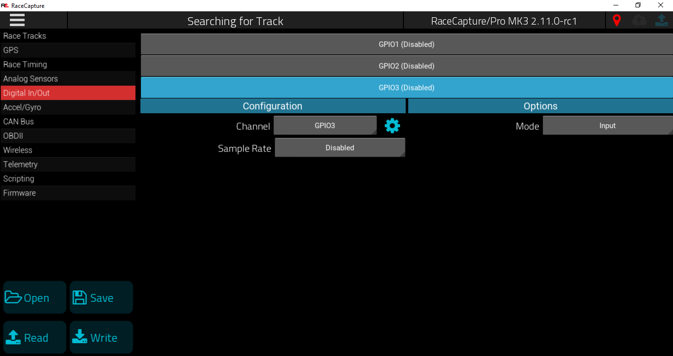

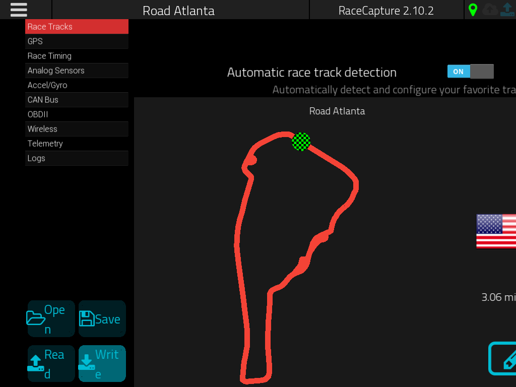

I thought that I would start to learn how to write scripts in Lua however when I went to the setup, the Scripting menu is not displayed. Hmmm... any idea why the Scripting menu is not showing up?

Setup screen shot
Setup screen shot
RaceCapture/Track (The version of race capture you have) does not support Lua Scripting. Sorry for the confusion!
