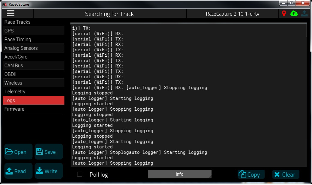

Everything works ok when I'm plugged into usb on my PC, connects to the 1.8.0 app on PC and phone simultaneously. I close the PC app via the "EXIT" button then disconnect from the PC (it was providing power only at this point) and plugged the race capture into a wall adapter for usb power. The Wi-Fi Module remains enabled, but access point gets disabled. I can then only fix it by plugging back into the PC and I can then see that access point has turned itself off. Not that it matters, but CAN and OBDII are both turned off for all of this.
Here is my log when connected to the PC and Phone.
WiFi Enabled, Client Disabled, Access Point enabled with Channel 11, WPA Encryption and 14 character password

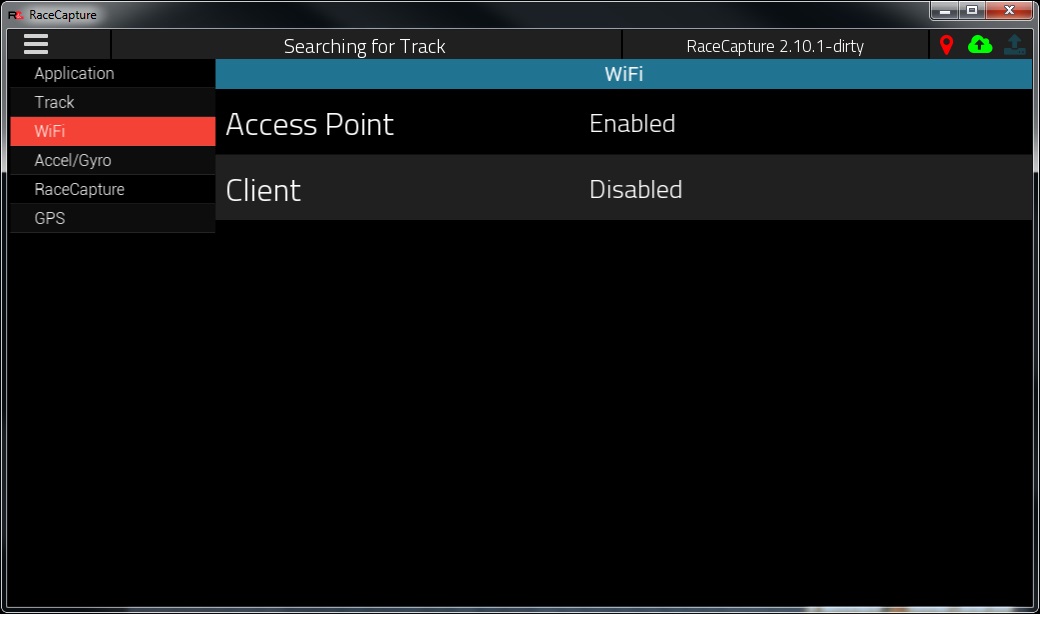

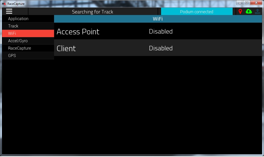

Here everything is enabled and working fine connected to the PC, and then directly after a power cycle the access point gets disabled. Screen shots of both below. Running 2.10.1 dirty

Hey Brent,
Yep that's where it's getting stuck,
Access Point enabled while connected to PC (wireless actually turns on and I can connect a tablet)
Press Write - still good
Press read - access point turns off
What do you recommend?

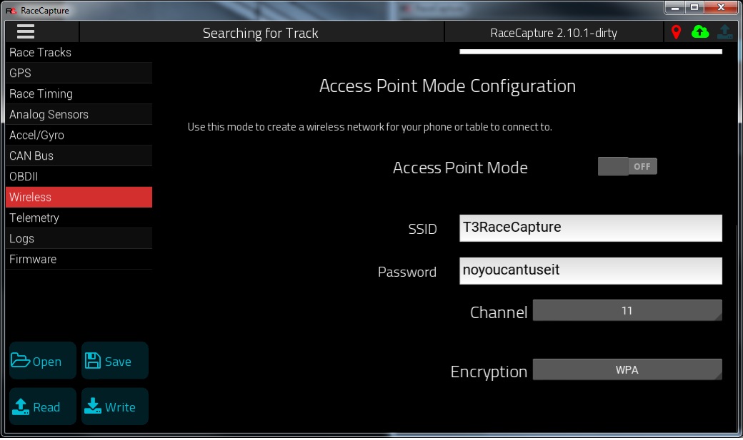

When configuring your access point, make sure your access point password is at minimum of 8 characters. the 1.9.0 app enforces this, not sure if you're on the latest.
Try checking that and let us know. Thanks!
slammed200
Posts: 20
Joined: Thu Nov 17, 2016 2:41 am
Location: Indiana
Post by slammed200 »
brentp wrote:When configuring your access point, make sure your access point password is at minimum of 8 characters. the 1.9.0 app enforces this, not sure if you're on the latest.
Yes, I'm at 12 characters. Running the latest app as well

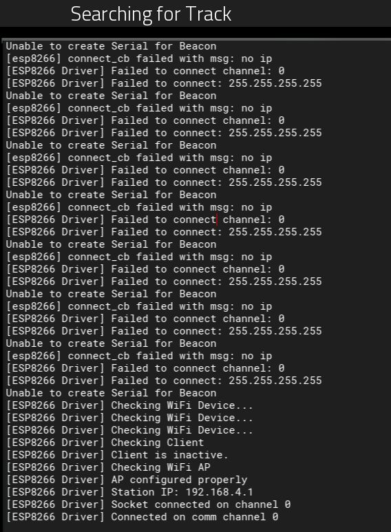

Gotcha. Ok - let's try this:
after enabling WiFi at the top level, and then setting the access point, password, and encryption settings, try writing, then power cycling.
After power cycling, go to the Log window in setup and click 'poll log' and copy the output from from the log and past it here.
slammed200

Done.
This log is after the first round of Enable Access Point and Write. (no power cycle yet)
before power cycle
before power cycle
before power cycle.JPG (115.27 KiB) Viewed 22769 times

Well, now just as before when I had that odd issue with the Encryption being a non-existent selection; now I deleted the text in the Client Mode fields and now with power cycles my Access Point Mode stays enabled. I even had it out to the car and it connects via OBD/CAN power. Hooray!
Now, if I could only get some CAN/OBD channels to work. i.e. RPM is giving a failure channel 12 log entry when polled.
Weird, there might've been a setting that RC wasn't liking. Glad it's working now!
