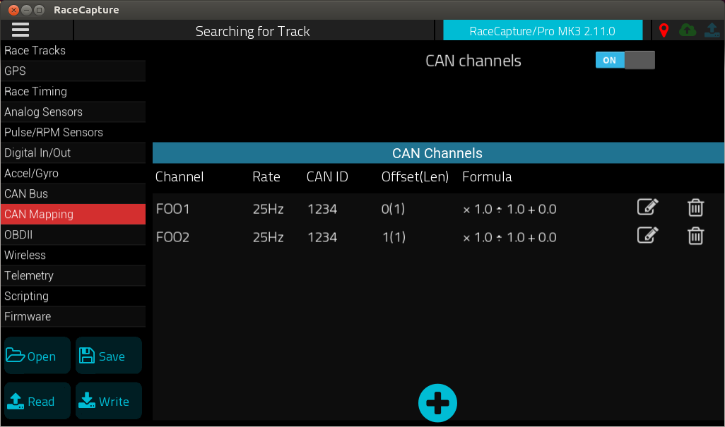

I re-tested adding a CAN channel, and I was able to verify that I *did not* need to power cycle RCP after adding a CAN mapping.
First, on a 2nd RCP connected to the primary I created a script that broadcasted some values on CAN ID 1234:
Then created a mapping on the primary unit that extracted both values from that CAN message into two different telemetry channels. I was able to add the 2nd channel (FOO2) without having to power cycle the unit.
If you're still not seeing the correct behavior then let me know and we can dig deeper.
Code: Select all
foo1 = 0
foo2 = 0
setTickRate(10)
function onTick()
foo1= foo1 + 1
foo2 = foo2 + 2
txCAN(0, 1234, 0, {foo1, foo2})
end
