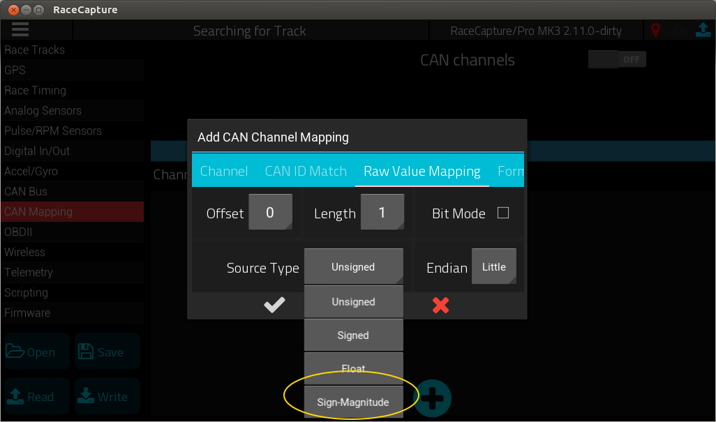

Are there any plans for a more robust ability to create a formula for a CAN mapping in a future release. The standard raw x a / b + c is great but doesn't cover all use cases. For example, on my 370Z, the formula for steering angle needs to be -> if raw>32,767 then -(65535-raw/10) else raw/10

Good question. Actually, it looks like your 370 uses a sign-magnitude approach for the steering angle, similar to the BMW E46. In sign magnitude, the highest bit represents the sign of the number. https://en.wikipedia.org/wiki/Signed_nu ... esentation
Fortunately, we already have that covered already in the sign-magnitude data type, where the raw value is converted to a +/- value for that data type; *then* the formula is applied, so it just works with the existing CAN mapping capabilities.
Happily, nearly everything seen in the industry is covered by the conventional formula. For anything that actually needs complex logic for mapping, there's the Lua scripting supported by RaceCapture/Pro and RaceCapture/Apex.
We talk about both approaches extensively here:
https://www.autosportlabs.com/racecaptu ... -released/
