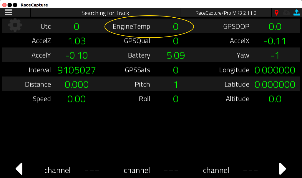

I see you have one OBDII channel enabed - EngineTemp.
When you have it plugged in and you have your laptop or mobile device connected, and the engine is running - do you get any readings on the EngineTemp channel in your RaceCapture app dashboard?
Note, you will need to swipe to the dash screen that shows all of the channels listed together in green digits (the raw channels view).
Also, can you try it on a different car, to see if you can get an EngineTemp reading?
Thanks for that. Your config seems to be ok.

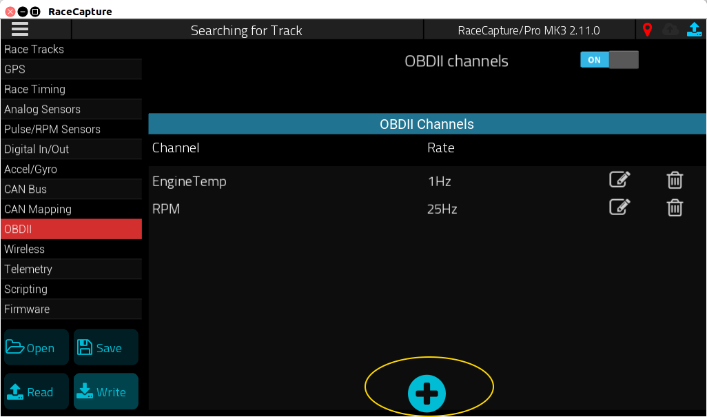

Great to hear. So you have Engine Temp and RPM?
You can do a C to F conversion by editing the OBDII channel and going to the right-most tab "Conversion". Choose the "C -> F" conversion. Make sure you write the changed configuration back to RCP to have the change take place.
Regarding what's supported - it varies by car. Almost all cars support a subset of SAE standard channels:
RPM, EngineTemp, TPS, MAP (manifold pressure) Fuel, and WheelSpeed.
Right now the best way is to try a channel and see if you get data on the selected channel.
Some things are rarely supported on OBDII - but that's where your direct sensor inputs on RCP comes into play; you can connect things like direct temperature, pressure and other sensors as needed.
Hope this helps!

Not sure what I did. Is there a procedure to add a channel? Do I need to wait for a period of time for it to show up. I feel like I just didn't do a step it get it connected. I may be wrong though.
