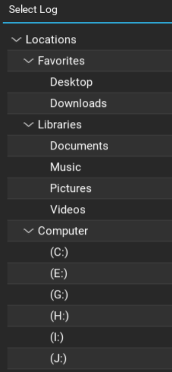

Does the RaceCapture app only work with locally connected drives?
How do you browse to a network attached drive which is located on the same workgroup? I can't seem to figure out how to browse to a network drive with format like \\NETWORKDRIVE\folder like is possible within Windows Explorer.
Hi - you'll have to map the network destination to a named drive, first - then you should be able to browse the contents.

Ah yes, I was cheating by browsing directly to the drive from within Windows Explorer since for some reason Windows network drive mapping wasn't initially working with my NAS.
