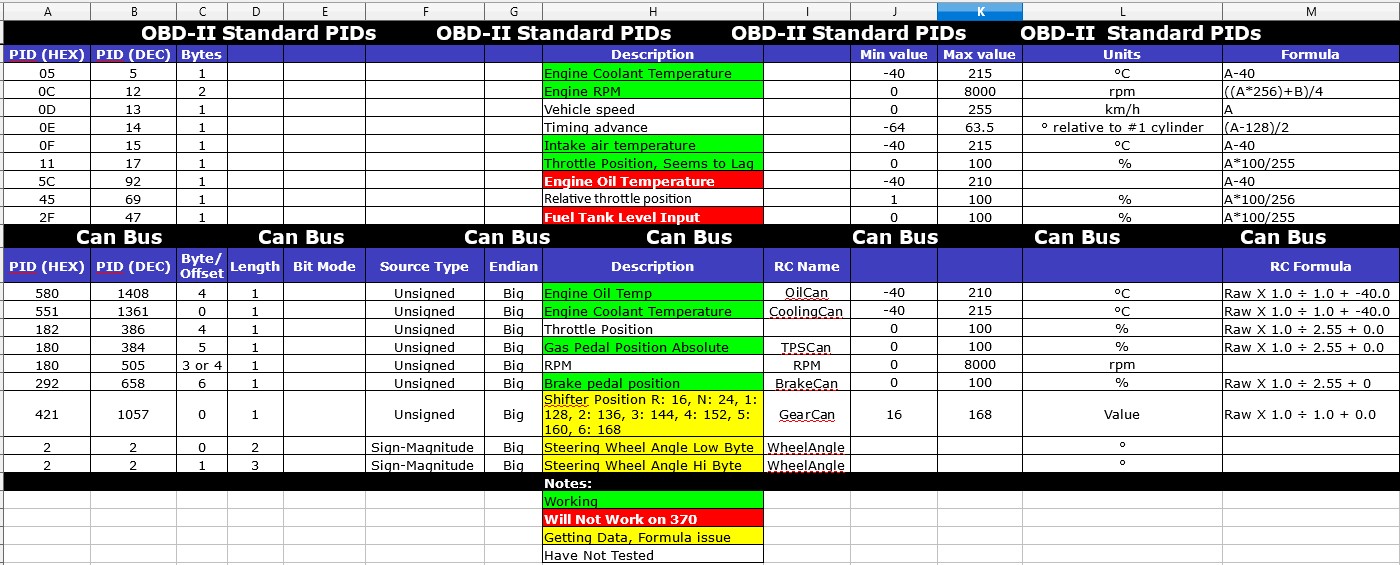

Here is a list a came across. I am currently working to adding them to me RC Track ans getting them working
370Z CAN.xls
(249 KiB) Downloaded 688 times

Post by cdoxp800 »
Did some testing today on some Can Items. I sill have more too test. Kind of stuck on this sign-magnitude approach for the steering angle and the Gear position cacluation for the shifter position. I am getting the Raw Values for the shifter position, but need to convert them to the correct values.
