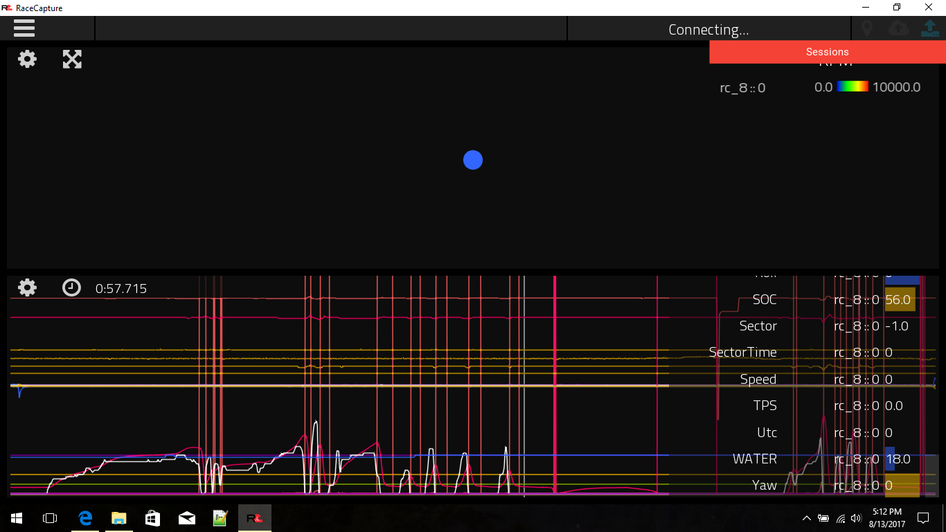

OK, so I was NOT running the latest app, am running it now but still had the same result.
My channel for engine temp already had no space so I changed it to have a space just to try something, loaded a file on notepad and made the same change there, saved it and imported again onto the app. It will now open, but I don't appear to have any values?
If I didn't screw it up, there should be a screen shot of what I see when I open the log...
Thanks a bunch-Curt

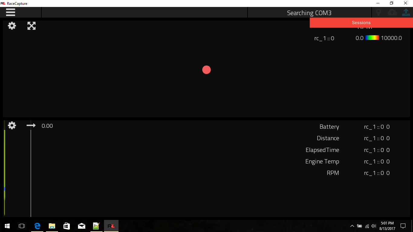

and here is what I see when I open a log file that I copied from the forum just now:

Hi, thanks for the update. Your imported log file doesn't appear to have any values because it looks like distance was not recorded in that log file. Maybe you didn't have GPS lock, and/or you weren't moving?
Press the arrow ( ===> ) icon on the line chart. This will switch it to time based view - you should then see your data.
