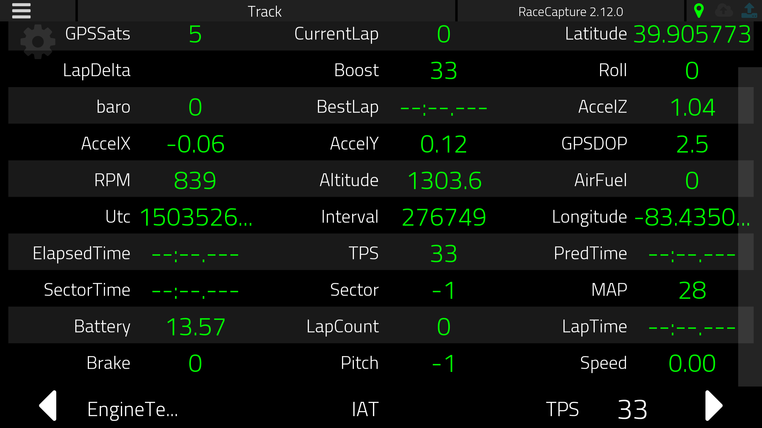

Attached is a screen shot of what was showing.
RCT for 2017 Honda Civic
- Screenshot_20170823-182236.png (214.95 KiB) Viewed 13892 times
Baro reading:
For the baro reading, is 33 in hexadecimal or in decimal? The PID field for the OBDII editor for RaceCapture is decimal.
If you suspect the 33 is really hex, try specifying the PID as 51, as 51 is the decimal equivalent of 33 hex.

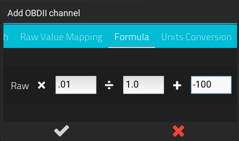

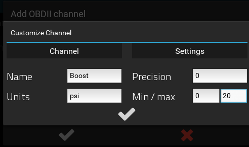

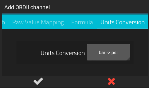

Calculating boost based on baro pressure:
As you know, boost = map sensor value - barometric pressure.
At the moment, RaceCapture does not support the ability to subtract one channel from another in the OBDII mapping.
However, what you can do is estimate the barometric pressure - at sea level it is ~100 KPa (technically 101.3) You can modify your OBDII channel to subtract 100 from the converted MAP sensor value and then convert it to PSI (on the last tab). You'll also need to convert it to Bar (which is the 0.01 multiplier in the formula).
Finally, customize the MAP channel to be Boost instead, by pressing the gear icon next to the channel name.
Here's a table showing barometric pressures at different altitudes:
https://www.avs.org/AVS/files/c7/c7edae ... f87b9e.pdf
Hope this helps for now!

2017 Honda Civic Type R
Settings to show my Boost pressure:
OBD2 PID: 11
Mode: 01H
CAN ID: 0
Mask: 0
Offset: 3
Length: 1
Source: Unsigned
Endian: Big
Formula: RAW*0.01/1.0 + -1.0
Conversion: BAR->psi
now to work on the other settings
If anyone has any input on any of the settings in the first post please let me know.
