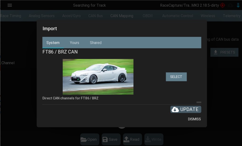

Re: Scion FRS, Subaru BRZ, Toyota GT86
FYI - The latest mapping for this ECU is already available in the system presets. Press the cloud update button if you don't see it in the list.
Hi, We have a CAN mapping system preset already for the FT86, with EngineTemp, Oil, Steering, Brake, TPS, 4 wheels, and gear indicator.
Are there any additional channels that can be added to this preset?
