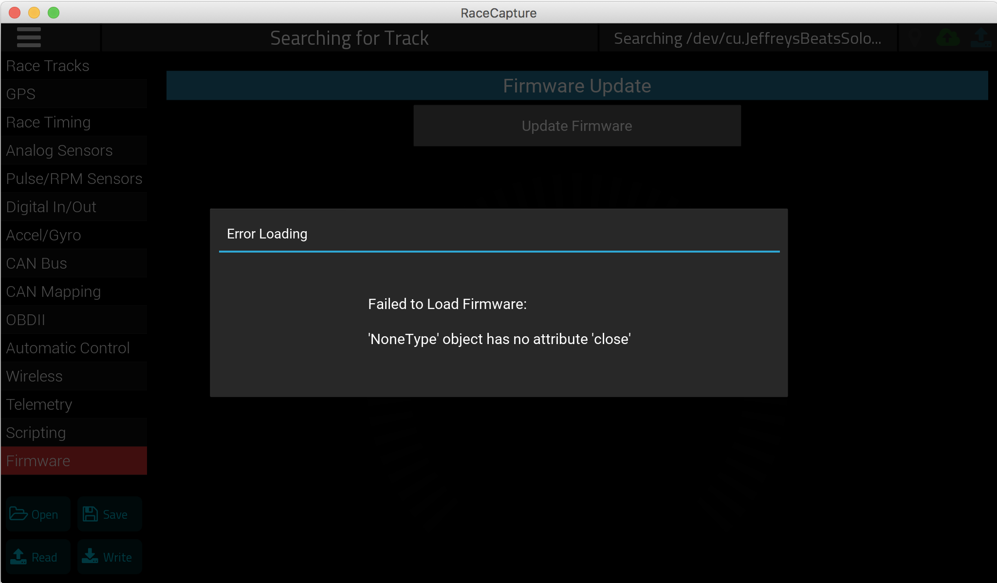

When I attempt a firmware upgrade on my Mk3, I receive an error. Using v1.12.1 of the app on OSX. Tried the alternative way to update and the app didn't present the setup option (didn't see the device).
Let me know of any troubleshooting steps....
-Jeff
Screen Shot 2018-02-26 at 13.40.02.png (176.94 KiB) Viewed 3343 times

I loaded up Windows 10 in Parallels and was able to update my RCP3 to the 2.13.0 beta firmware.
Do the Windows and Mac versions of the app have any differences that may cause the issue?
Hi Jay,
Thanks for posting it. This is a known issue, we're currently working on it.
https://github.com/autosportlabs/RaceCa ... ssues/1545
Glad you got it working through an alternate way!
