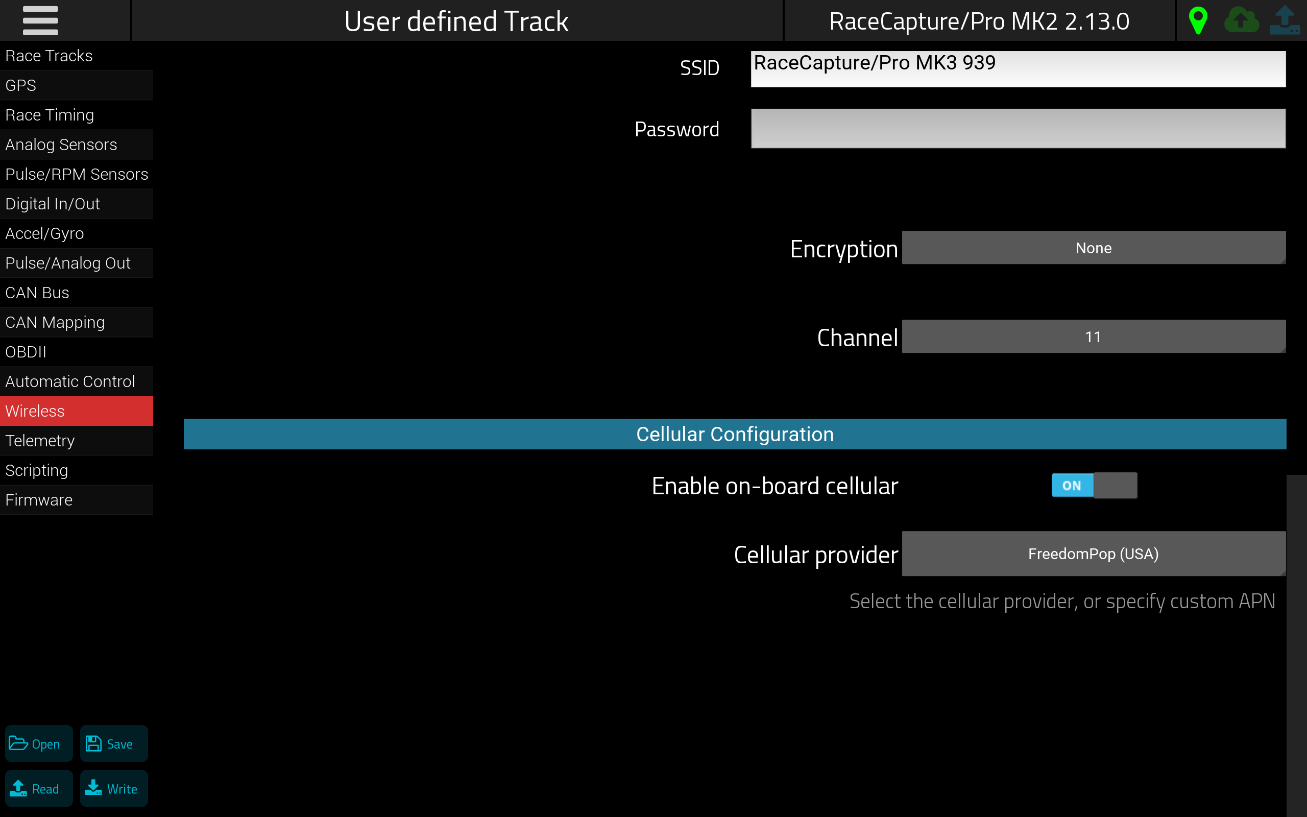

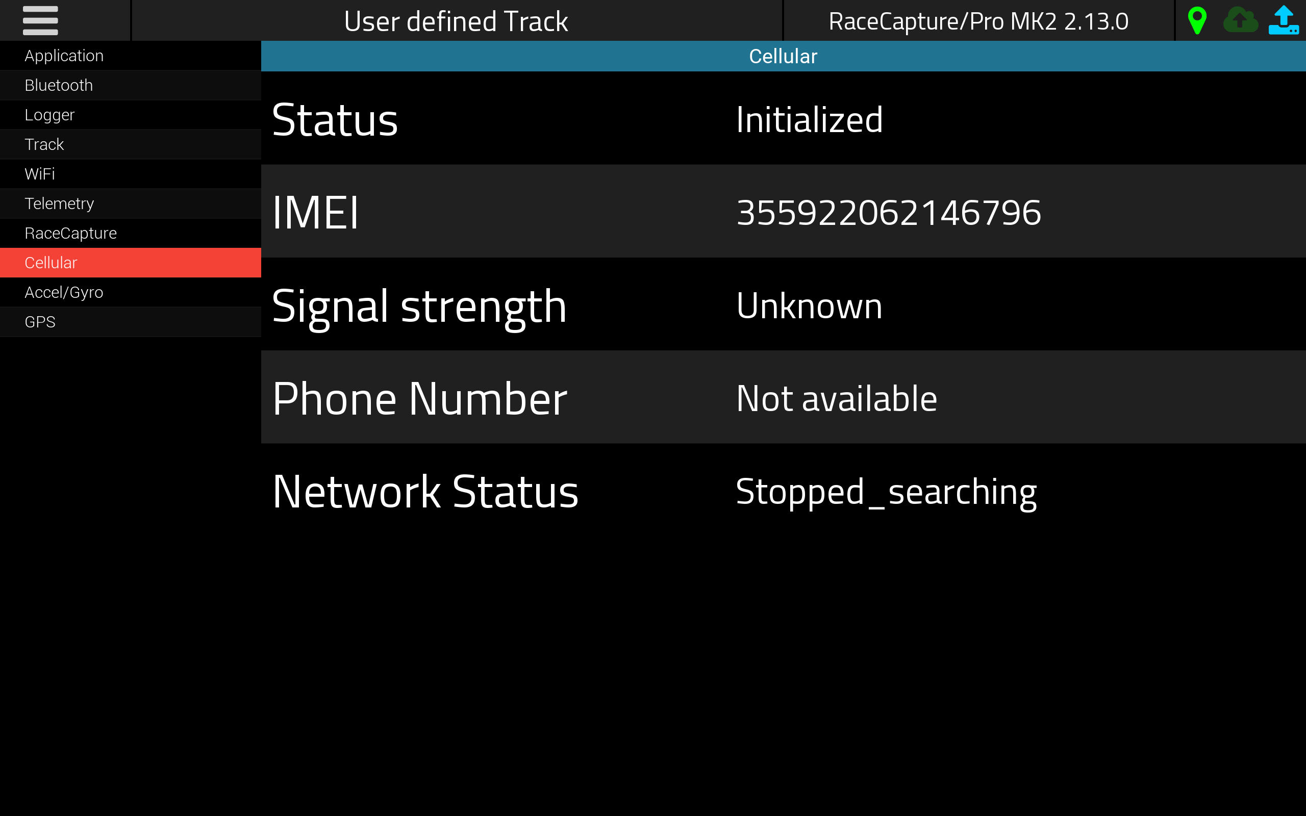

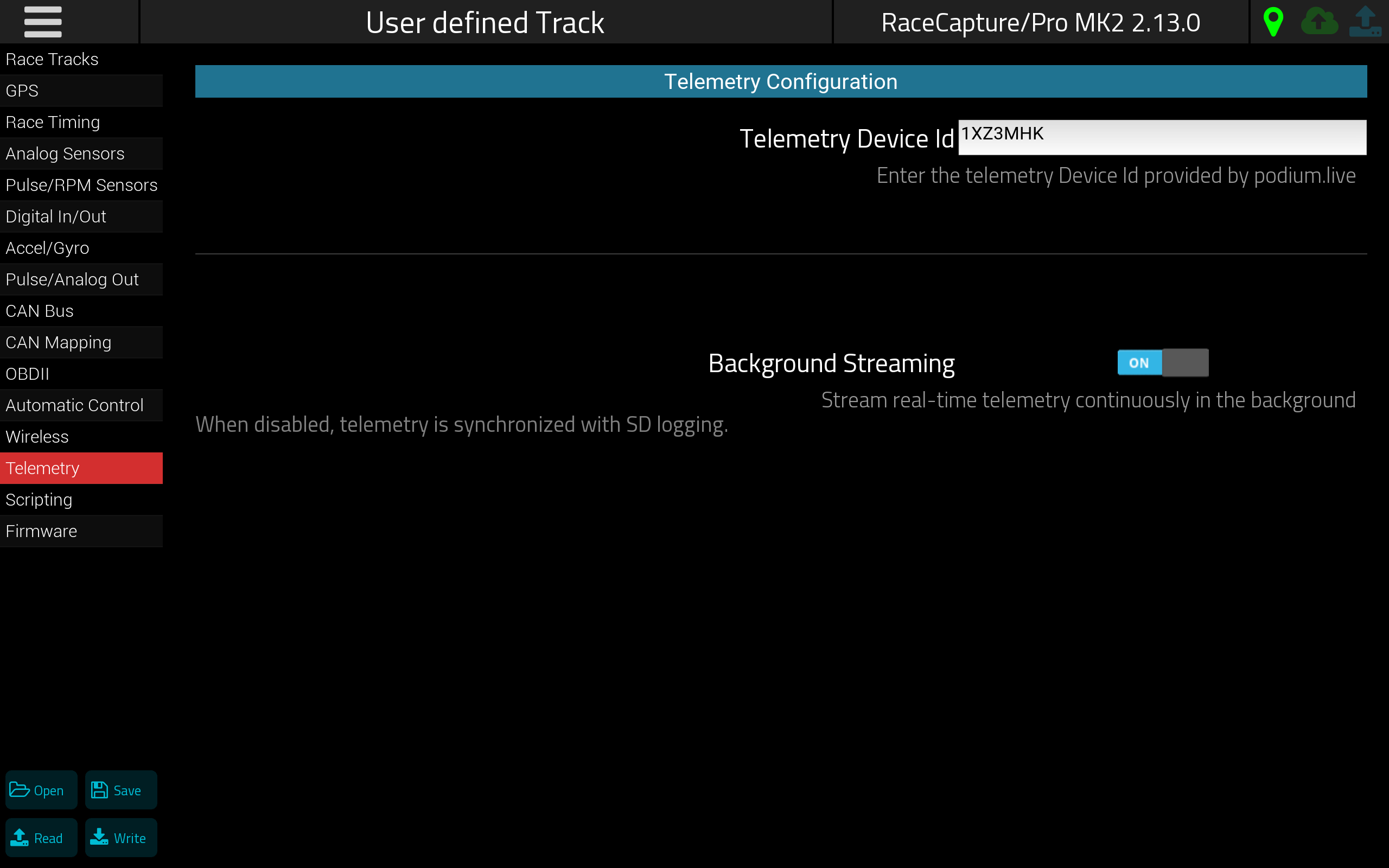

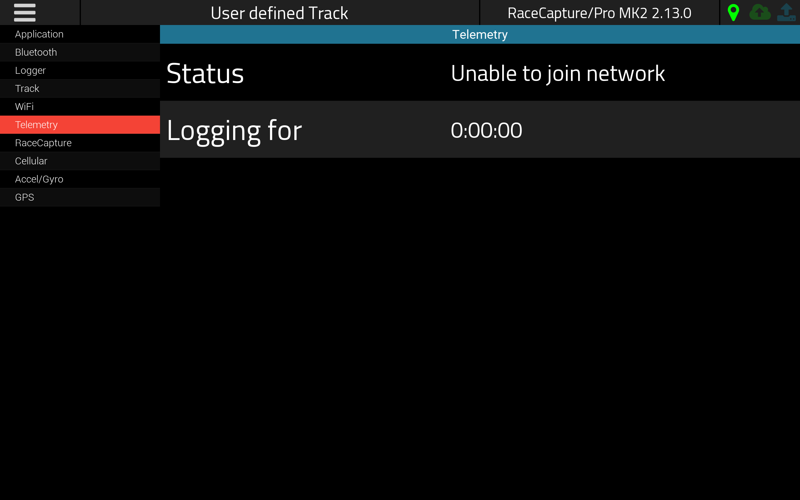

Trying to figure out why my MK3 box won't connect via cellular and transmit to Podium. I'm using the FreedomPop SIM card. Below are some screen shots, let me know if there's any other information you need I left out.

another
You said you had a RCP MK3, yet your screenshot shows MK2.
If you flashed the 2.13.0 MK2 firmware by accident, you can just re-flash it with the proper MK3 firmware. That should clear up your issue.
