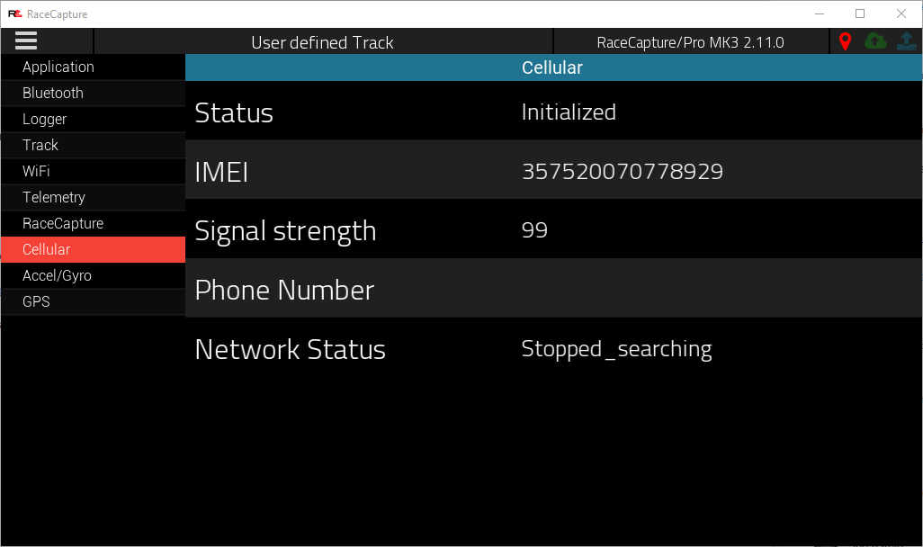

  1. The first issue is that the Cellular status does not show the phone number.
    The status also changes from "Initialized" to "Error Initialized" to "Registered"
  2. The second issue is that the Signal strength never changes from 99 - no matter if the module is plugged into USB, 12V and the antenna being plugged in makes no difference.

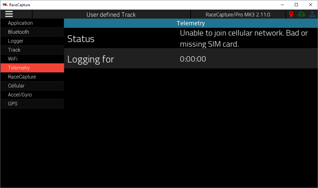

  3. Finally, the Telemetry status screen shows "Unable to join cellular network. Bad or missing SIM card"
Note that I have tried all 3 AT&T APNs and also same as my phone. Next step is to try with my cellphone's sim card (waiting on adapter).
All signs point to SIM card but what should I tell AT&T? Ask for a new SIM? Go with the prepaid ones?

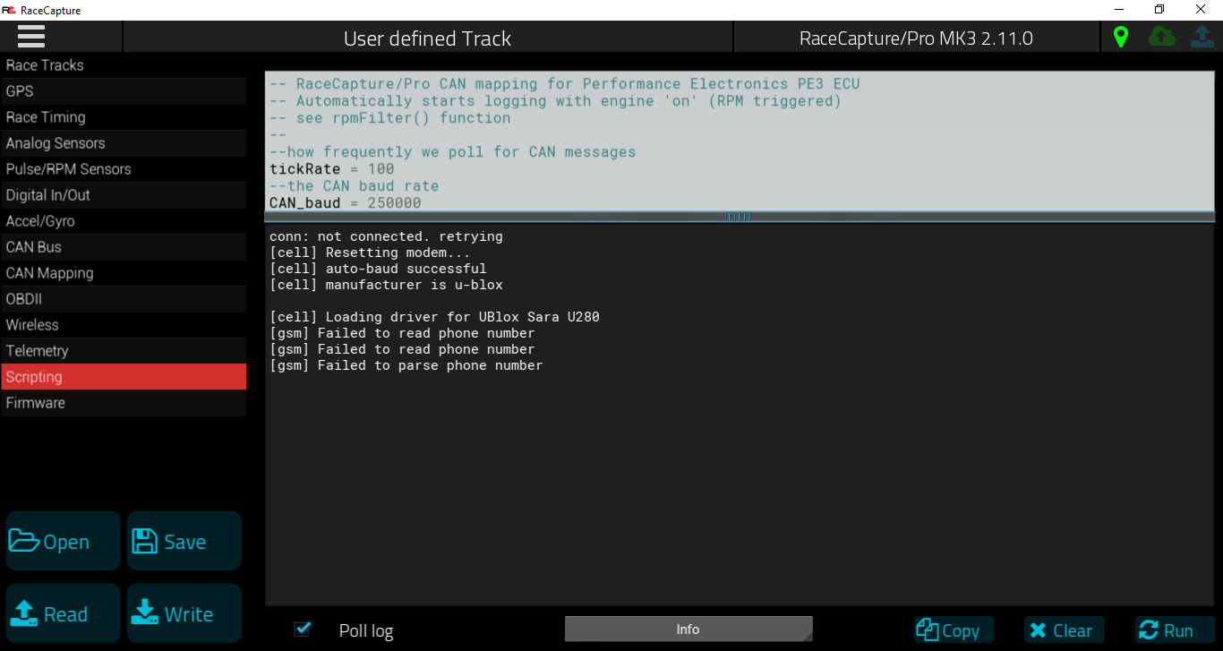

Could you try watching the RCP log under scripting while it's connecting to see what the activity is? You can also paste the contents of the log as a reply. Usually there are some helpful messages there.

I also had the same problem but when i check the info in scripting it shows failed to read phone number. How can i rectify this problem. All the other things in setting are same as soviet. I am using custom APN. I referred to the website link and done the setting accordingly.
Thank You.

Vrushabh - unfortunately, the 'cannot read phone number' - is an error message that pops up *even if* we successfully read the phone number from the SIM. This is causing confusion and we apologize for that.
You can check that RCP can read the phone number, IMEI and other cellular statistics by going to the System Status page when the app is connected to the RaceCapture device.
If you see this information (IMEI, phone number...) then you know the SIM card was read correctly.
Typically problems after that are related to reception issues, and not having the proper APN settings.
