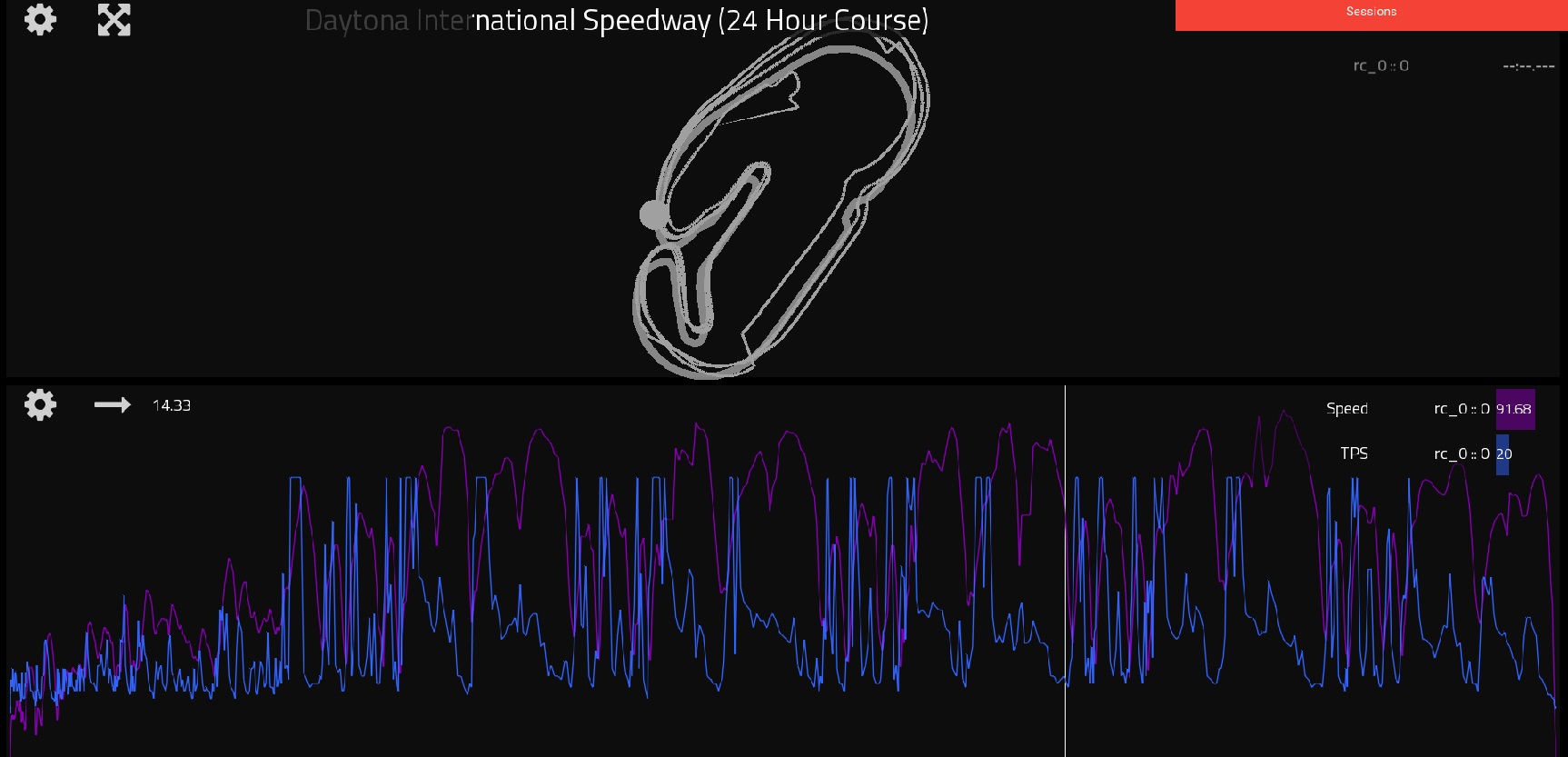

My MK2 recorded a session, but I don't even know when it was? I essentially hit the track 3 times. There is no date or time stamp. I manually found the track but it never picked up the star/finish line. The picture shows what the analysis button gave me from the RCP. Nothing loaded to the SD card on my tablet - nor did I expect it to.

This is what appears in app
Looks like it you didn't get lap times because due to not detecting the track you're at.
You should add your favorite tracks to the list of automatically detected tracks under setup. How to-video here:
https://www.youtube.com/watch?v=jAgFQ9k ... QSYS25xW5j
Once you do that, you'll be able to see individual laps registered.
Hope this helps!
