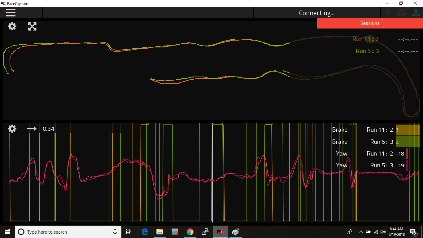

I've always found the analysis feature on the RCP software to be a bit cumbersome. My biggest grip was the way it displayed my throttle or braking channels. See this image:
This weekend, I had a buddy codrive the car. I sent him our logs to compare. He sent me back this screenshot:
His graphs are WAY easier to read.
I know he is sitting at a desktop with a 27inch screen. I'm using a tiny 13 inch laptop. Could this be it?
I use this laptop for all the car work because the battery last forever ( a full day ) and its light 2.5 lbs.
Is there any way to fix this?
12 inch.png (161.8 KiB) Viewed 2137 times
the scaling on the charts is determined by the min/max values originally set up in the channel mapping. When you go edit the channel under setup, you'll see the ability to set min/max. This will influence the min/max values scaled in the graph.
We have plans to allow the min/max values to be editable after the fact under analysis mode after importing; that will be enabled in a near-future analysis release.
