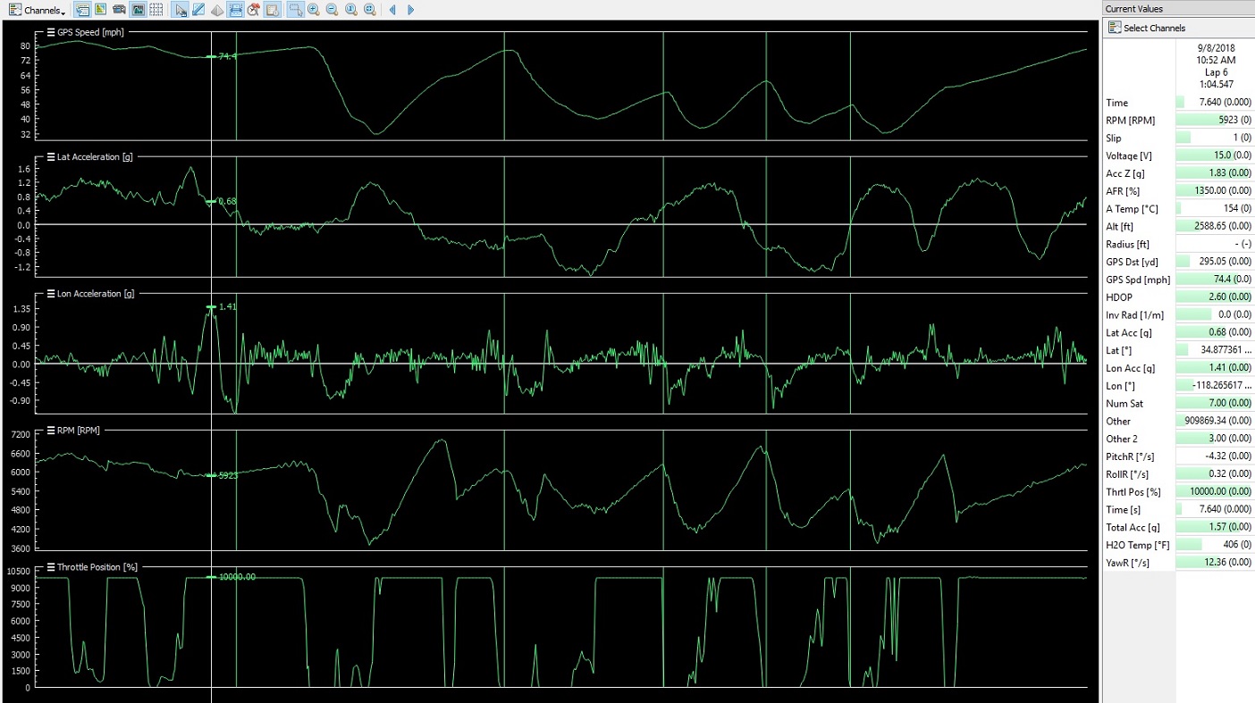

The IMU is stable when viewing the 3d accelerometer visualization page in the dashboard. I have attached a screenshot of the data. I also noticed that the Pitch change in degrees/sec is way out of whack. Also, there is no way my 140 whp Miata could accelerate at 1.4 g! Although it would be fun!
Lon Accel Issue.jpg (239.96 KiB) Viewed 11342 times

The accelerometers and gyros only receive a light treatment of real-time filtering in the form of an exponential moving average filter, which may still let some high frequency noise through, which could make it look like you're seeing higher g-forces than realistic.
We're looking at some post-processing filtering, using a Savitzky Golay filter which will help retain the sensor's curve while filtering out noise.
We'll also look at exposing the tuning knobs on the real-time filters to see if that can help as well. With filtering, there's always the risk of introducing lag in the data, so fine tuning will be required.
