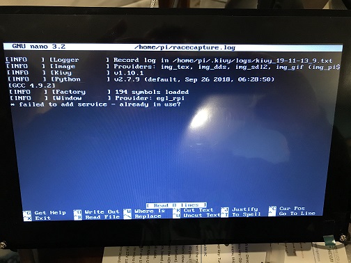

I started off with a RPI4/waveshare 10.1 screen and could not get it to run the RCP program. So I stole the RPI3B from my sons Piper project and tried working with that. I was able to get everything to work fairly easily, but I struggled getting the touchscreen y axis inverted. After about 4 days of researching and trying different things I was able to fix it with a couple of things.
1. I had a mouse plugged into a USB port. When I looked at the .kivy log file it was recognizing the invert_y command, but after that it was recognizing the mouse. Once I unplugged the mouse and rebooted I was able to get it to work properly.
2. I had the [input] lines in the /home/pi/.kivy/config.ini in the wrong order. What I ended up with was:
[input]
mouse = mouse
device_%(name)s = probesysfs,provider=hidinput
ads7846 = hidinput,/dev/input/event3,invert_y=0,rotation=0
After I made these changes, the screen seems to be functioning normally. Hopefully this might help someone else from banging their heads against the desk for as long as I did!
Lastly, I probably should get the PI3 back to my son - so has anyone tried getting this set-up to work with a RPI4? I started off buying a 4 (not knowing any better) and I can not get the app to run at all. Here is the log file that I am getting after manually running the /opt/racecapture/run_racecapture.sh:
Any suggestions you have would be great as I am already working way above my head.
Matt
