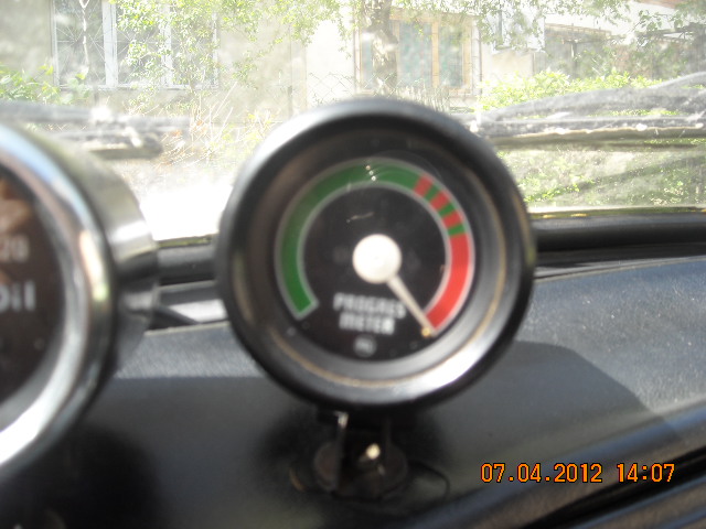

Vacuum source: one for MJLJ (blue), another for progress-meter (vacuum-meter).
