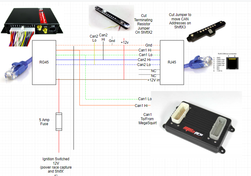

Bumping this - any guidance for me on this? As a reminder - trying to run ShiftX2, Shift X3 (via CAN2) and MegaSquirt (via CAN1).
Please see the attached wiring diagram.
Does this make sense?
I also need some help on the jumpers. I'm assuming I would cut the terminating resistor jumper on the ShiftX2, correct?
Also, I understand I need to cut the jumper to move the default CAN base address from 931328 (0xE3600). I know I can change it by breaking the trace bridging the ADR1 jumper on the bottom of the ShiftX3 circuit board
Once I cut this trace, how do I distinguish between commands to the ShiftX2 versus the ShiftX3? In other words, If I want to turn on an LED on the ShiftX2 - how to I distinguish this from the same command that would turn on an LED on the ShiftX2???

Hi Dave, you have it pretty close to correct. Placing ShiftX2 and ShiftX3 on CAN2 while having Megasquirt on CAN1 is a good plan.
Here are some suggestions:
* Keep ShiftX3 on the primary CAN ID (don't cut the jumper)
* Place ShiftX2 on the secondary CAN ID (cut the jumper)
With ShiftX3, control it with the built-in firmware support. With ShiftX2, you will need to discretely control in Lua by sending it CAN messages directly. The built-in firmware support for ShiftX2/3 introduced with firmware 2.15.1 focuses on controlling just 1 unit, which covers 99% of installed use cases, and keeps things simple.
We have it further documented here:
https://wiki.autosportlabs.com/ShiftX2# ... of_ShiftX2
Hope this helps!
