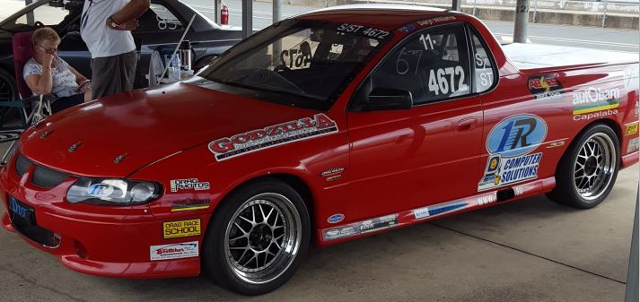

- In the QR pits.
- DTOY-3.JPG (59.2 KiB) Viewed 21420 times

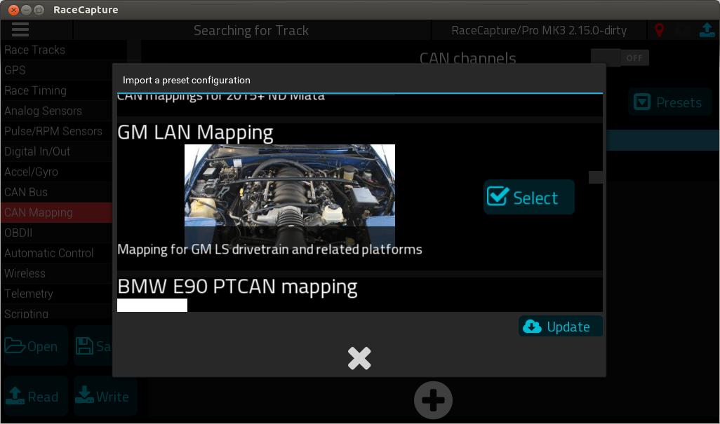

The easiest way is to simply wire up the CAN bus to the ECU, paying attention to CAN1 or CAN2, then load and enable the GMLAN preset to see if data is flowing across those channels.
The preset defaults to CAN1, so just wire it to CAN1 on RaceCapture and also ensure the baud rate is 500K (the default).

Some research shows that this ecu is canbus running at 500K. Looking at your earlier post, the pic shows a L series engine with fly by wire throttle when selecting CAN Mapping.

By any chance is there a URL for a relevant source code for GM LAN mapping for me to learn about GM CAN packets?
Re: GM / Holden E38 ecu
Hi, the GM LAN CAN mapping is available in the RaceCapture app as a system preset - you can import the preset and inspect it through our app, or save it to a config file.
