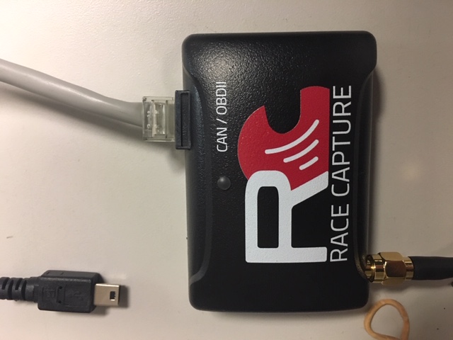

The light on my RC track does not lid up unless its connected to the USB cable.
I am assuming that if I power up the brown wire and ground the white\orange from the ethernet cable it should lid up?
Just got my device recently and want to make sure I am on the right way.
If you plug it into regular OBDII using the OBDII cable, does it then power up?

The pin out from the cable I had was from RJ45 T-568B but the pin out posted our the website is for a RJ45 T-568 A.
Now I have it working so I can continue. I am sure I will have more questions coming soon ;)
