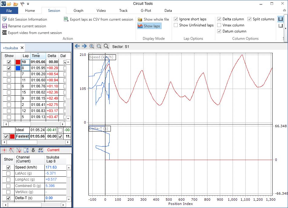

Can anyone confirm if this tool still works correctly?
I have tried it with the sample logs Brett uploaded some years ago, and it appears to work until you try and compare more than 1 lap and the graph plots go all over the place.
I'm hoping it's just an issue with the sample files? I really want to be able to use the RCP with Circuit Tools.

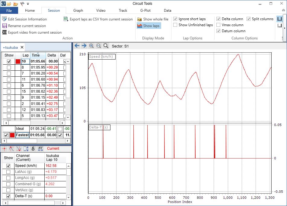

Post by jabtronic »
Here's an example using the Tsukuba sample log

Post by MCScott »
Sorry I didn't see the above reported bug. It seems the VBO file format uses an unusual time stamp format that required some additional special conversion handling. The new version of the utility I've posted here fixes that problem, and also provides a somewhat better handling of the "heading" value that Circuit Tools uses to compute lateral G forces.
I had promised to post a github repo of the source code, but it's now so many layers of hacks that I don't think I can support pull requests. I may someday get around to rewriting this in a much more extensible way, but no promises.
