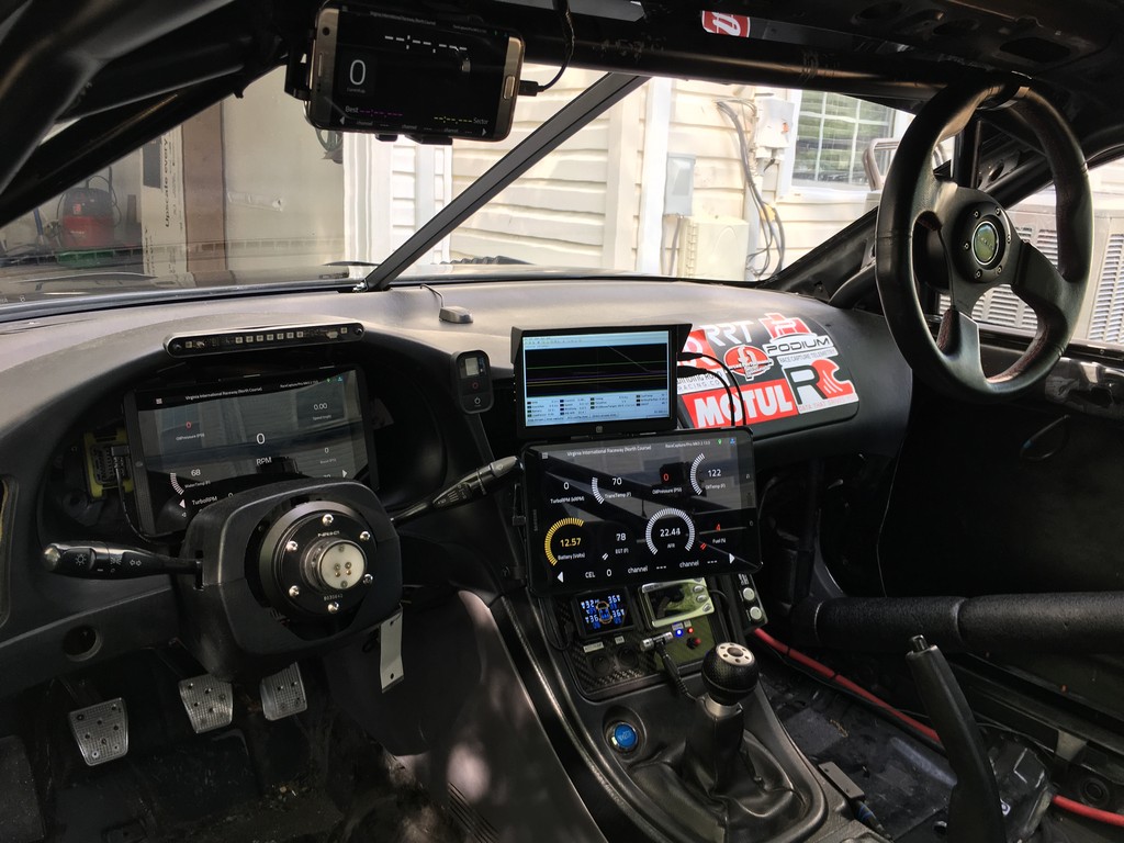

I ran my new setup with my K1 and 10.1 dash this weekend at VIR and it worked very well, and impressed a lot of people attending Hyperfest. I never touched the tablets, they just automagically worked when I turned on the car.
