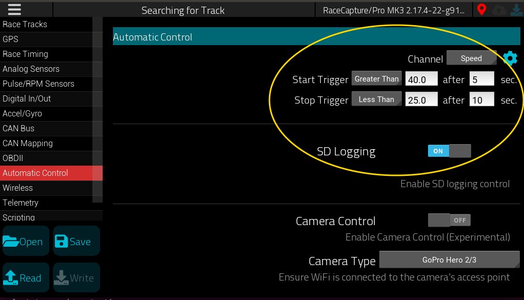

Sorry we missed this post!
Let's baseline with some information:
1) What hardware revision do you have? RaceCapture/Pro MK2 or MK3 or /Apex ?
2) What firmware is it currently running?
3) How are you triggering the logging? Are you using the automatic logging feature built-into the firmware under Setup / Automatic Control? Or, are you using a script to trigger logging (old style)
If RaceCapture has problems logging, it will report it to the RaceCapture Log. You can access this log by going to Setup / Scripting and checking the box "poll log"
Instructions: https://wiki.autosportlabs.com/RaceCapt ... apture_Log
This will have messages about when it starts and stops logging, with any error messages.
Finally, SDHC (32GB and smaller) logs are required, ideally with a fresh FAT32 format.
https://wiki.autosportlabs.com/RaceCapt ... rd_logging
Please let us know, we'll watch this post for updates. Thanks!

- sd_logging_automatic_control.jpg (85.09 KiB) Viewed 16354 times
