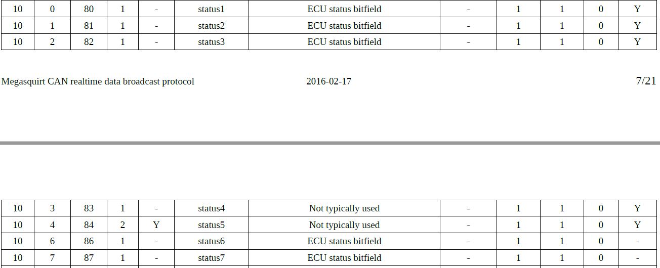

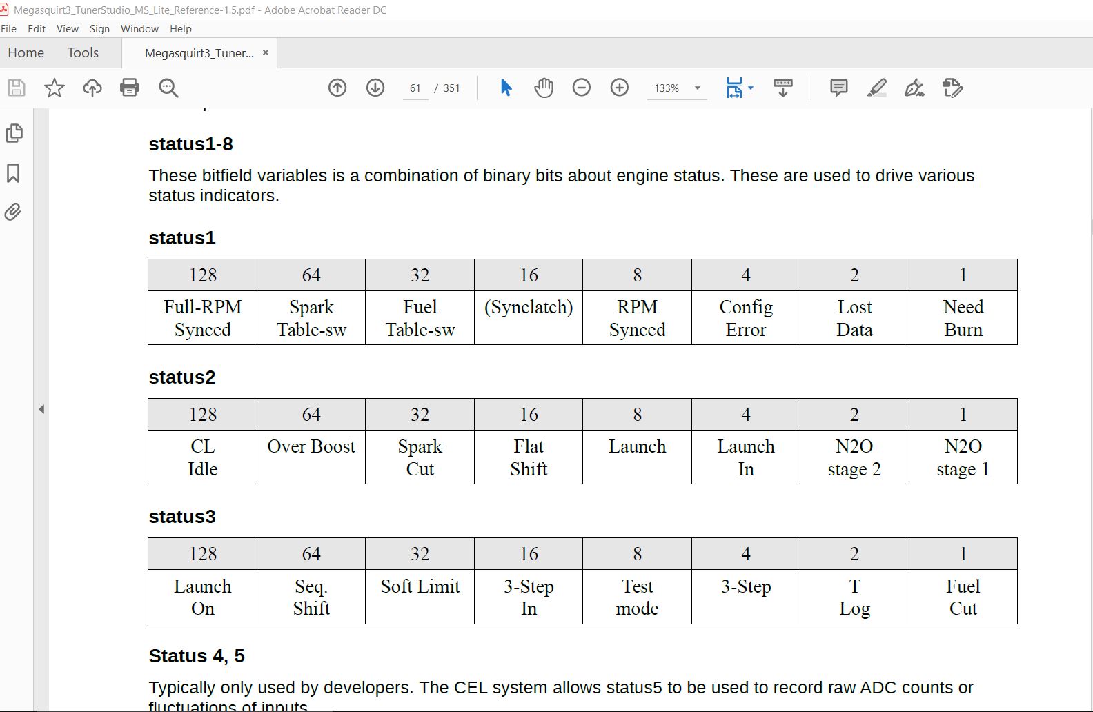

See attached. You can use Can Broadcasting to send over many available engine states. In this case I'm using "Launch in" to make my coasting channel clearing by filtering out the time when I'm also pressing on my clutch.
The ID is 1520+10 so 1530, different offset for each status bit field, all big endian, length 1. Enjoy.
