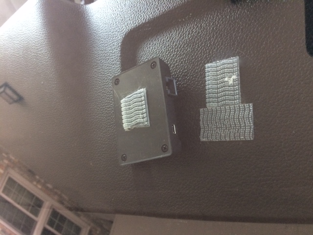

The alternative to hook and loop is the Scotchbrand type fastener.
http://www.scotchbrand.com/3M/en_US/sco ... 615&rt=rud
I use it for my GPS and now for the RaceCapture. The glue side has stuck to my vinyl dash for several years now. I did carefully clean the vinyl before attaching.

dewittpayne
Posts: 67
Joined: Sun Dec 11, 2016 1:07 am
Post by dewittpayne »
Pictures taken through the windshield so there are some reflections.

Nice. I really like that stuff too, much more positive hold than hook and loop with virtually no play.
