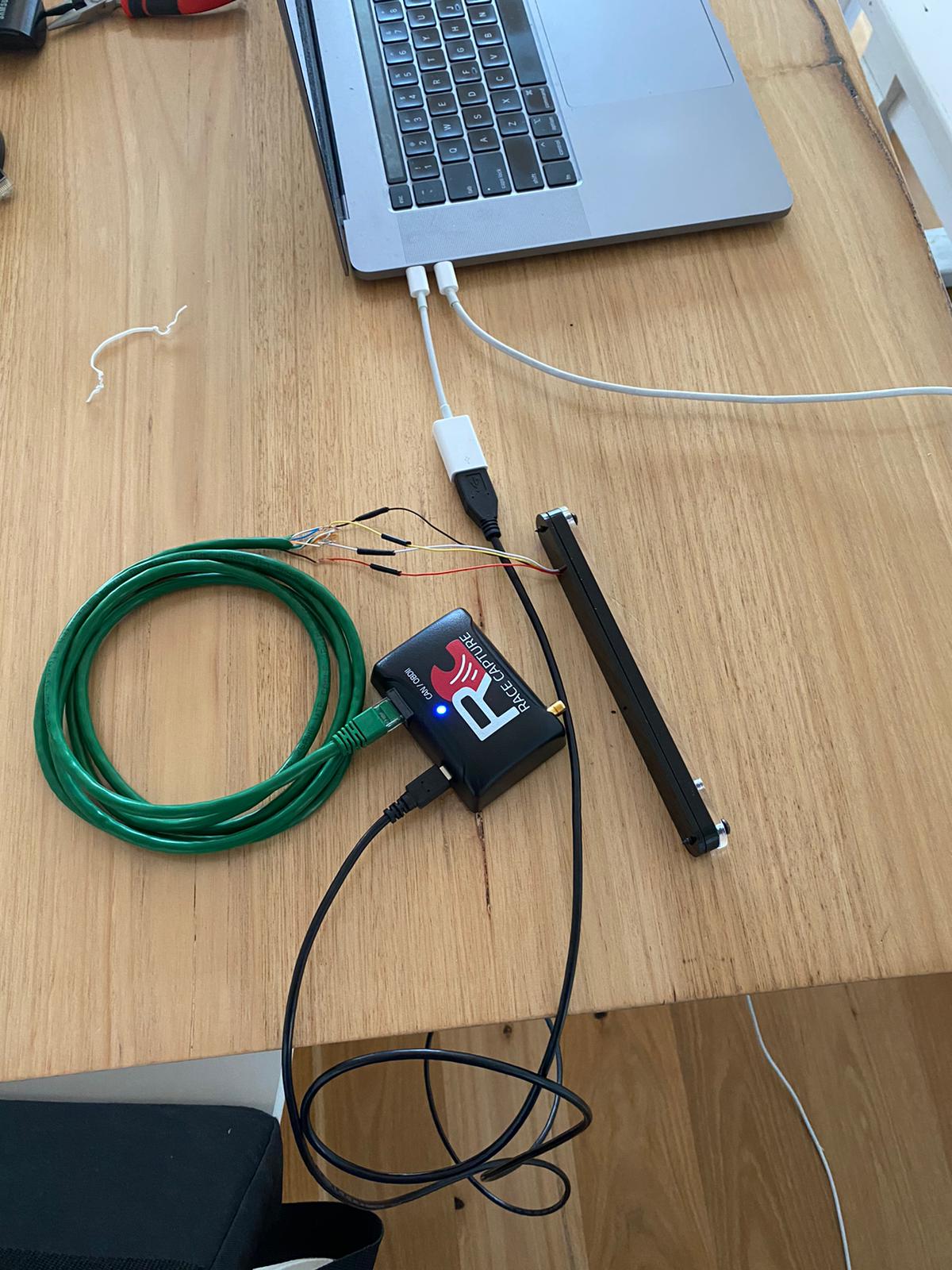

Hi Everyone,
I just recently purchased one of the last ShiftX2s (could find any 3s) and am trying to connect it to my RaceCapture Track Mk2. I’ve followed the instructions in the wiki posted above and plugged it into my laptop to try out the disco demo but I get nothing when running the script. I have the last firmware and the RJ45 cable is a patch cable not a crossover, any tips?
Re: ShiftX2 instructions / install guide
ShiftX2 needs a separate 12v power. See this part of the ShiftX2 installation guide:
https://wiki.autosportlabs.com/ShiftX2#Wiring
