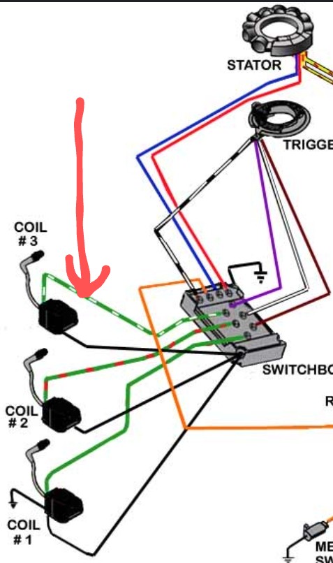

I dont have a oscilloscope. This is the primary input currant to the coil at idle its around 180V and at high RPM its around 250V. This is an all mechanical ignition system with no computer involved.

This is where I'm getting the signal
Re: Help with coilx setup
Thanks. Although you can't provide data, there is a definite chance it will work if the waveform matches what CoilX expects (as documented in the wiki). As you can understand, there's no guarantees it will work.
