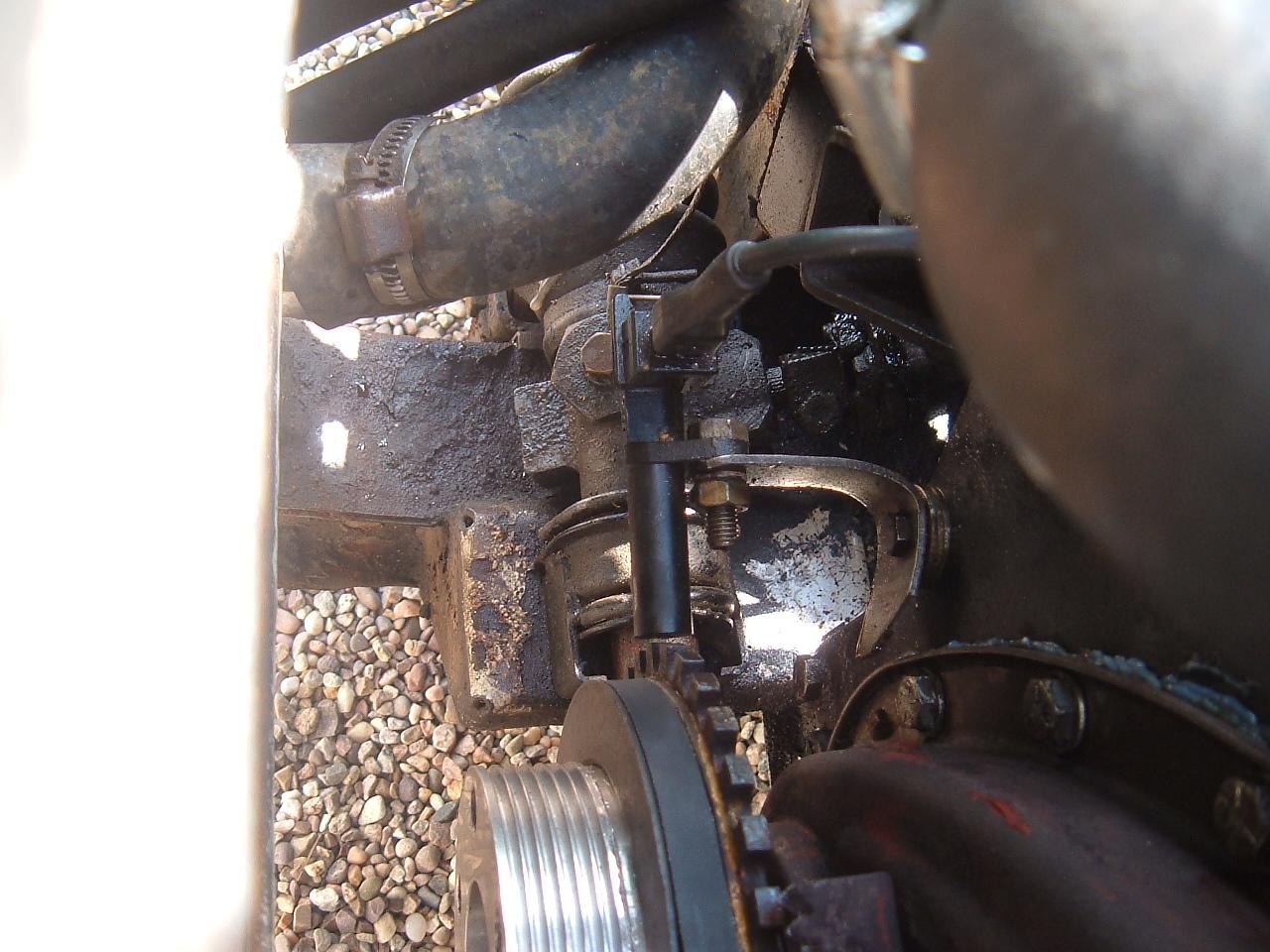

Here's the VR sensor and trigger wheel. The bracket is far from pretty but is strong and does the job well. I had the wheel welded on to the crank pully, done by eye, and then turned to take any 'off center' discrepency.

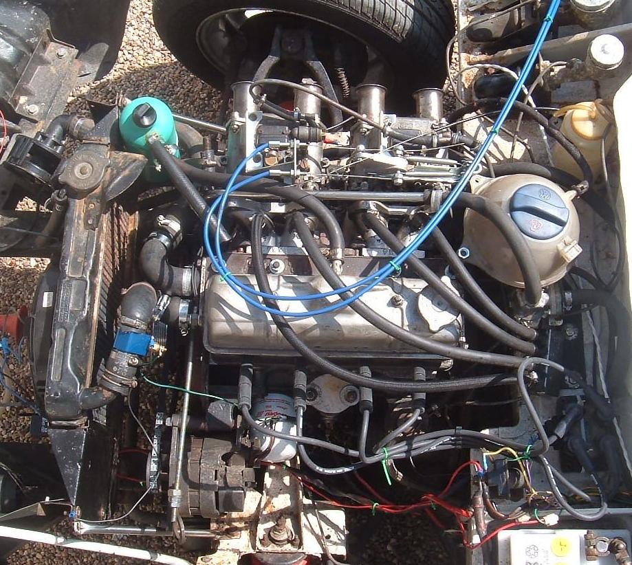

Here's the engine bay with the coil packs on the left hand side, as i said there's some tyding up to be done.

I see that you also just happen to have a new 6 rib poly vee pulley mounted in front of the existing belt, now I wonder what you might be planning to do with that.
I assume that the fact that the Eaton M45 from a Mini has a 6 rib poly vee belt is purely coincidental :wink:

Yep, quite right, i do have Eaton M45 from a Mini. The whole reason i changed the ignition to MJLJ was to get rid of the old dizzy to make room for the blower. I'll post it up when its in. :lol:
