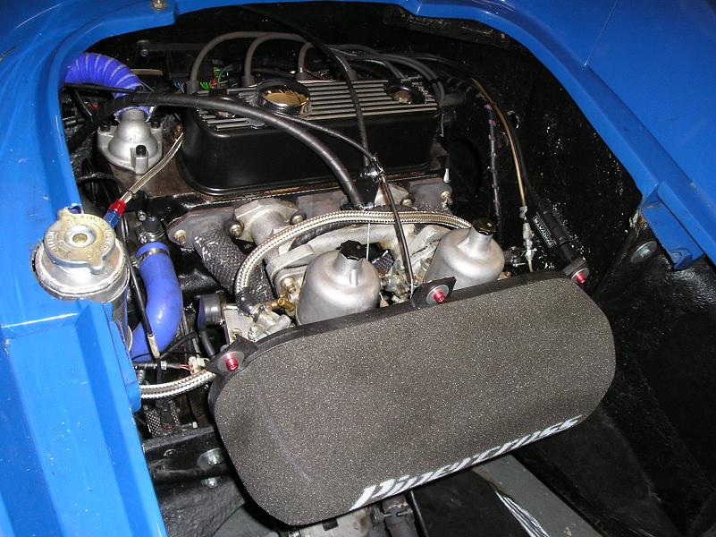

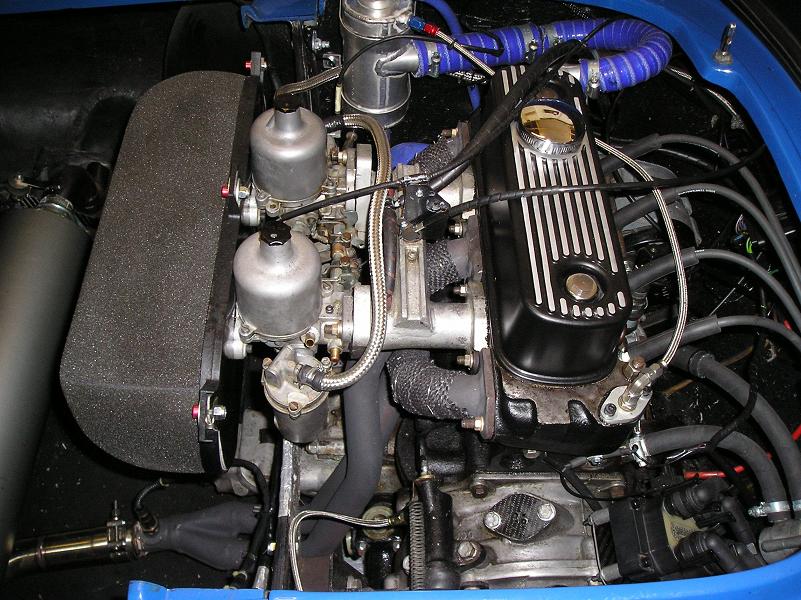

Current engine spec:
1293cc
Stage 3 head
Twin 1.5SU
10.5:1 CR
643 cam
Renegade exhaust can
Just finished installing the MJLJ. Fired up first time. (still using the old firmware)
Much crisper throttle response and mid range power than old electronic Aldon dizzy. Still some mapping to do but feels instantly better.
Some photos of the installation can be seen here:
http://s122.photobucket.com/albums/o249/matnrach/
matnrach
Posts: 22
Joined: Mon Sep 11, 2006 3:14 pm
Post by matnrach »
Just finished installing my modified engine now with waisted 36/31mm valves, further port mods, 1.5 roller rockers, 11:1 CR and side exit exhaust to comply with noise regs
Also using the latest configurator which helps mapping.
4 aug 001b.JPG (118.59 KiB) Viewed 5709 times
4 aug 003b.JPG (108.41 KiB) Viewed 5709 times
