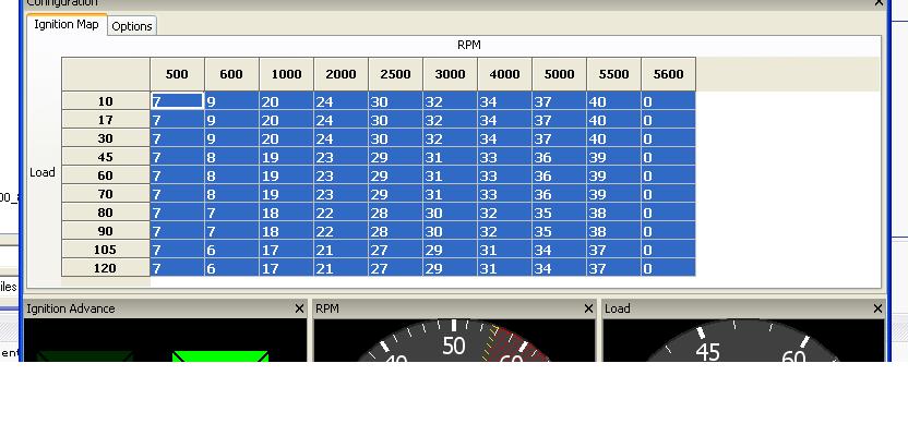

I know how to adjust the ignition bin values, i.e the load bins which i have no. 10 at 120. How do i change the dial and runtime chart to show this reading. At the moment the dial is going off maximum when i drive and the chart shows a straight line at the top while the reading is above the default value.

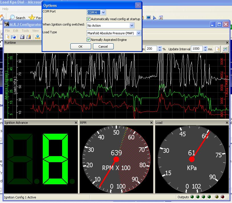

As you see (as picture 1) this is what i'm getting with the ignition map loads (as picture 2), or am i supposed to be doing something else?

Sorry i think i'm being a bit thick. My car is N/A and i take it 100kpa is atmospheric so the reading couln't pysically go higher unless by forced induction. I was looking at the runtime chart and thinking it was going of the scale as it was hitting the top. Saying that though is there any way to change the RPM scale to suit individual cars upper limits?

I just took the car out for another spin with the N/A box unticked and was hitting 104Kpa. I'm only in Worcestershire (not to low) but i guess it's because of the blue skys and sunny where i am - meaning high pressure. Does this mean at full throttle the MJLJ could double up as a barometer? :wink:

If you look at the runtime chart pic above you can see where the chart stops and the peaks go beyond, not at rest but under accelleration. So i guess i've done something right :)
