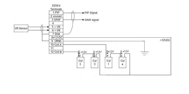

cribbj i read earlier in this thread how you were having problems with weak spark using a single edis unit for 8 COPs. i'd like to run 4 COPs for my setup: should i expect to run into the same problem?

cribbj wrote:Dr. Occa, are you asking about driving 4 COP's from an EDIS8 or an EDIS4? In other words are you still trying to drive pairs of COP's as I was? Are you running an 8 cylinder motor or a 4 cylinder?
I've "heard" of someone running pairs of BMW COP's, but wired in series (mine were in parallel), and he said it worked, but it may limit the spark at high RPM.
I would think that pairs of COP's with integral ignitors could be run (triggered) from an EDIS unit. This would be an interesting experiment.
thx for a speedy reply.
we read the same write up in regards to the bmw COPs setup cribbj!
i borrowed your diagram and altered it for an EDIS 4 application (my application) and applied the in-series configuration. i have another EDIS4 module i could always hook up in parallel but am hoping the single EDIS will suffice. i also wasn't sure about the secondary grnds on the COPs so i did not address them in the attached diagram. any insight would be greatly appreciated.
