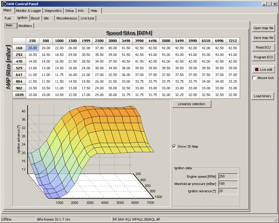

smaller increments
The map i have is as good as it gets with the current firmware, the engine is a Alfa 1.7 16v boxer moter with twin 40 idf carbs fitted, i am not the first to do this ,as the carbs have more character than fuel injection, fitted as standard to this engine. I have to disagree regarding smaller increments for light throttle use, all of the current maps that i have looked at for my engine have quite low amounts of advance up to 2400 rpm, and they do have smaller increments, ie emerald ecu. Also when refitting the dizzy it seems smoother up to that point! I know that these ecu's are at the top dollar price wise, I just thought that it would be a great for every one to have this option. ps this is not a complaint just a sugestion.
Thanks Lee

I still don't think resolution is particularly a problem. For example, on the map shown, if you changed from linear interpolation to cubic, you would easily alter the timing by more than 0.5 degrees at points off the grid. What you probably want to do is to have more grid points where the timing changes quickly. You can do that with the megajolt by adjusting the bin points. If the map is good and it's not running so well, then you may have some other problem with your megajolt.
Looking over that map you posted, I would scrap the top 5 bin points and use them down where it matters.
You're not running a Formula One engine, nor are you using fuel injection, nor are you using a carefully and precisely blended racing fuel, so a variation of 0.75 degrees just isn't going to matter. Or it certainly won't unless you like running close to the grenade point!
Change your mapping strategy to use interpolation to better advantage at the top end with two (or three maximum) BINs from 4000 up.
Again, only two BINs for idle and something like 1300 RPM.
Use the rest to give good control in the region where you are experiencing surging.
The idea of 0.5 steps sounds fine in the sales literature but in anything short of an extreme racing engine in a very carefully controlled environment, it is just that - SALES PITCH
btw, I have 3 BINs at 3800, 5200 and 7500 on a supercharged six cylinder that runs in the 'OMG it's going to blow' territory and found no advantage with my earlier maps that wasted more control up there. From idle up there are BINs at 800, 1400 and 2200. The extra BINs and control between 2200 and 3800 stopped an issue with blowing head gaskets apart every time I jumped on the gas in the mid range.

IAW MAP
Hi Paul, the above map is something that i posted,i received it from a friend with a programable ignition system. and is in no way conected or used by megajolt. it was just to show incremental changes between 1000-2500rpm. Regards Lee
