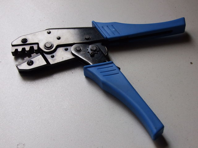

I have a ratchet crimp tool, similar to the one in the picture below. Effective, and really does give a good connection.
It has 3 spaces for different-sized connectors. The Molex pins fit in the smallest one - make sure that you crimp the right bits - 1 holds the cable sheath, 1 holds the wire itself, and leave alone anything else that's sticking out (that's used to locate the pin in the casing).

That picture was lifted from the web pages of Vehicle Wiring Products, but mine came from another source that's now gone ebay and they're almost impossible to find nowadays. VWP are a top-notch company that I can strongly recommend. They also have other types, from cheapies up to expensive ones.
That crimp tool is for non-insulated terminals only.
I have a book about auto wiring which recommends a different tool - similar to the PR3 model on VWP's crimping tool page - it looks a lot like the one in my picture but it doesn't have a ratchet. Apparently it gives all the power you need with a good feel for what you're doing. The downside is that a couple of years ago they cost about £75 ($100, A$150 approx. if my conversions are correct). The one I've got is fine though, and far better than the cheap-and-nasty ones.
I've attached a picture of my ratchet crimp tool - now well used!
