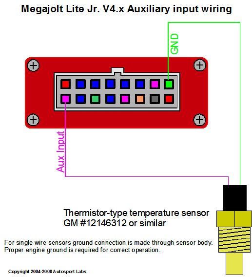

Hi i have fitted a coolant temperature sensor to a V4 and i`am receiving a higher reading when the water cools . How can i change the voltages around in the AUX INPUT CHANNEL OPTIONS so i can keep the gauge scaling aspect the same , left to right?

Post by Patriq »
magicecu wrote:Hi i have fitted a coolant temperature sensor to a V4 and i`am receiving a higher reading when the water cools . How can i change the voltages around in the AUX INPUT CHANNEL OPTIONS so i can keep the gauge scaling aspect the same , left to right?
In the configurator go to 'auxiliary input options' under 'tools'
There you can enter the desired value for each bin and each voltage reading from your sensor. Or just a scaling factor.
You can also read a bit more in this thread were I've been discussing a similar matter regarding the V3 MJLJ.
http://www.autosportlabs.org/viewtopic.php?t=2100
Also see here in the documentation:
http://www.autosportlabs.net/MJLJ_V4_Op ... figuration

Hi thanks alot for your help but i think for the moment its more for the scaling side to do perhaps later, in the mean time i have decided to get a GM#12146312 sensor, the one advertised in the MJLJ V4 Installation Guide. A PTC sensor and not a NTC sensor, just a bit of tapping to do. All done and working apart from trigger sensor positioning on a 1.8 K-series but only as a backup ECU until i have got the mapping side figured.

Hi can any one tell me whether the coolant temperature sensor used for the AUX Input has to be a PTC to work with the default voltage scaling, and is this what the sensor described as for example in the Vehicle Installation Guide GM 12146312 ?

If the thermistor temperature sensor causes the ohms to rise and the voltage at the same time when it is heated it is a PTC thermistor and that is what relates to the V4 software AUX input scale, i have an equvalant sensor to the advertised one ,a direct replacement but the ohms go down when heated. I will probably give it some more checks.
ptc - positive temperature coefficent - resistance increases with temperature
Also
ntc - negative temperature coefficent - resistance decreases with temperature - these areprobably more common in day to day life

Post by magicecu »
I was able to get this working by changing the 'Load Axis Calibration' Scaled Value round and saving and writing to the MJJL the read values, by using the saved base map.
