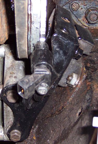

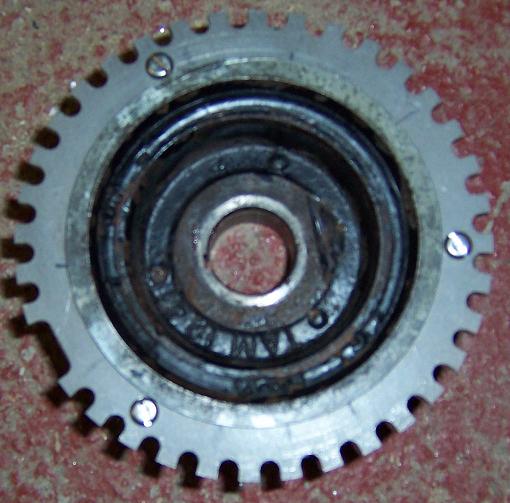

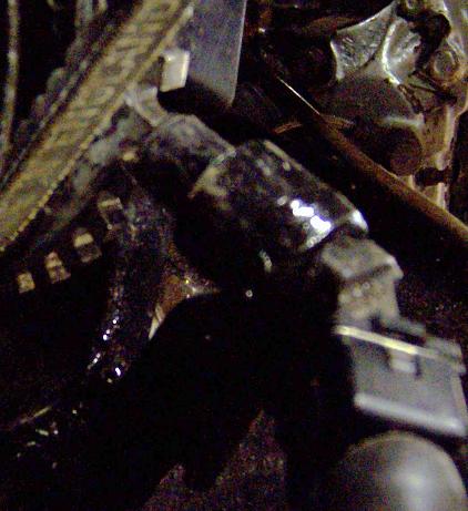

Bought the megajolt V3 a couple of weeks ago as I have decided to revisit my mini project that has been un-touched for 6 years. 1293cc, competition high boost head, 10cc pistons, (8.5:1 compresssion ratio), competion camshaft, straight cut drop gears and gearbox. I needed to get rid of the distributor as space is very precious. Before fitting the MJ I used the standard dizzy to get oil pressure up having had the engine not run for so long, once I was happy everything was ok, in went the MJ.
I am very impressed, starts and revs well, currently I am using a standard metro turbo map (found on a forum somewhere), but I have added a switch to the unit so I can switch between maps. The other has a more 'tuned' configuration, hopefully a good starting point once run in alittle. Not driven it anymore than down the drive to wash 6 years of dust off, seems to drive ok though. :)
Aiming for a MOT soon so I can report how is drives for real soon! Amazing device for the money, very well supported on the forums, excellent work Brentp! I am keen to get the hard rev limiter, just waiting to see if brentp sorts a cheaper shipping option :)
Anyway, some pics so far...

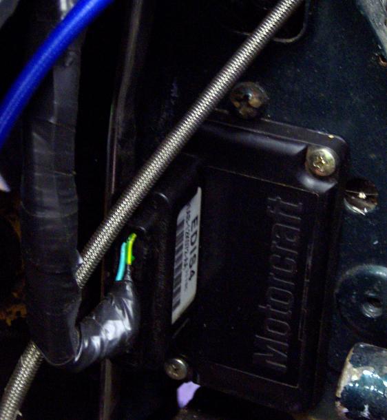

more pics...

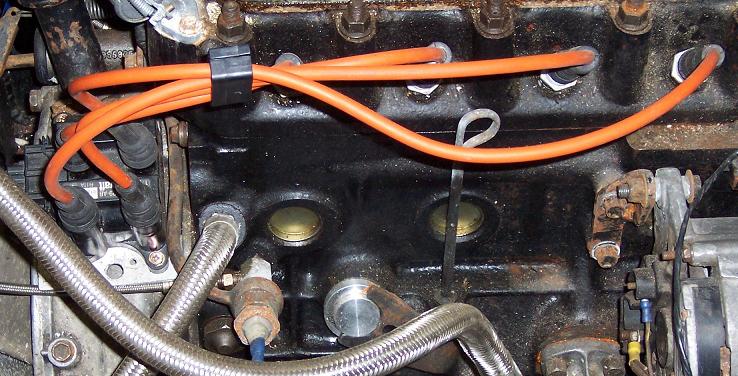

final one...

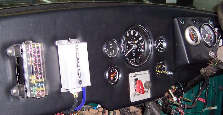

Car/engine is a bit surface rusty in places, can't expect anything other when it has been sat for so long. Had to put the MJ on display I am so impressed :D Hopefully tomorrow I should have a lot of the intercooler pipework complete and get it up and running again.

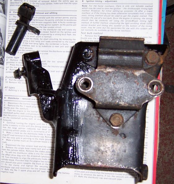

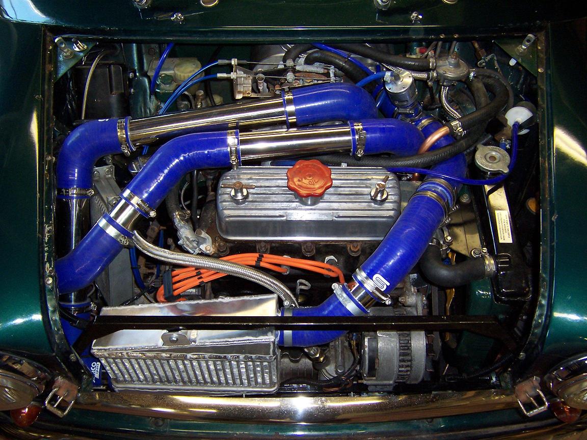

Pretty much the finished engine bay, the MegaJolt installation allowed space for the intercooler.
