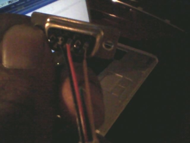

here is my connector from the back with the longer side on top.

Sorry I wasn't clear before. When I suggested you check the cable for continuity, I meant to put one end of the meter on one of the RJ11 pins, and the other end of the meter on the appropriate DB9 pin and see if there is continuity between the pins.... I didn't mean for you to check actual voltage levels on the serial connectors.
I've updated the graphic in the wiki to further clarify the cable pinouts:
http://www.autosportlabs.net/MJLJ_V4_Op ... rial_Cable
Use your meter in resistance / continuity mode to check each pin of your custom cable.
According to your picture- do you have conductivity between:
black wire (DB9 pin 2) and RJ11 pin #1 ?
red wire (DB9 pin 3) and RJ11 pin #2?
Yellow wire (DB9 pin 5) and RJ11 pin #3 or #4?

yes i have continuity .6 across the board
