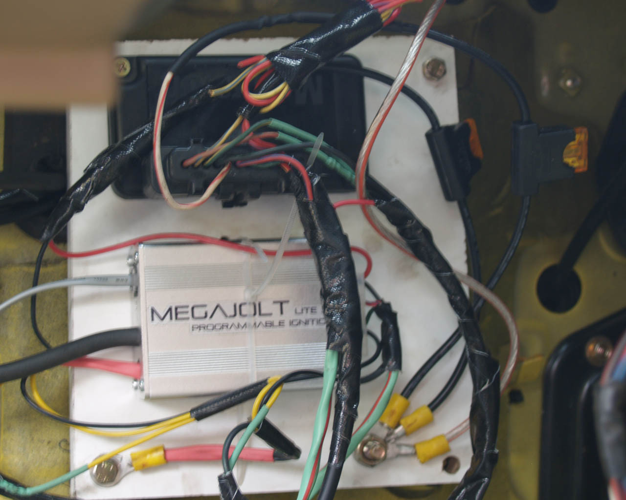

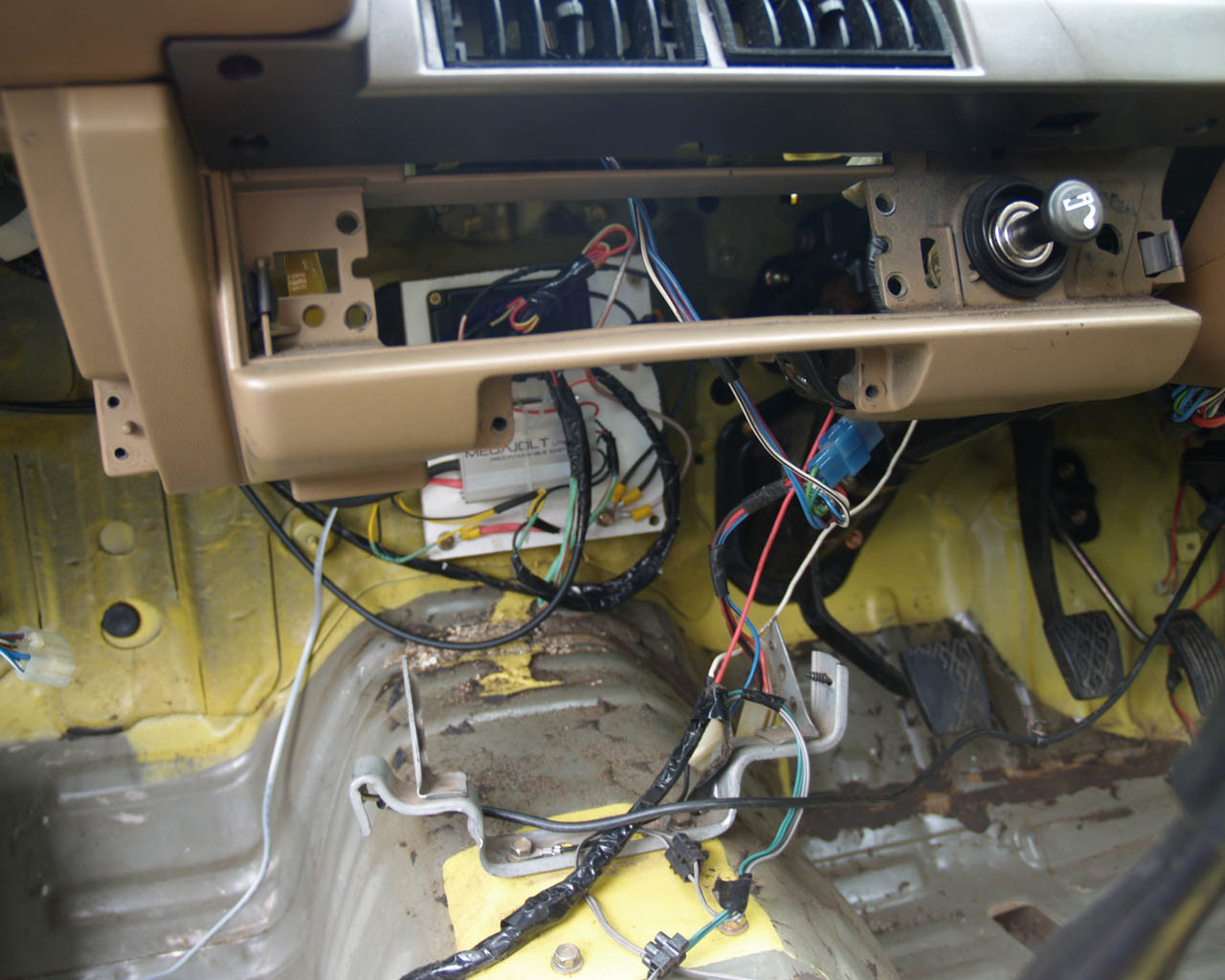

And now onto the Megajolt

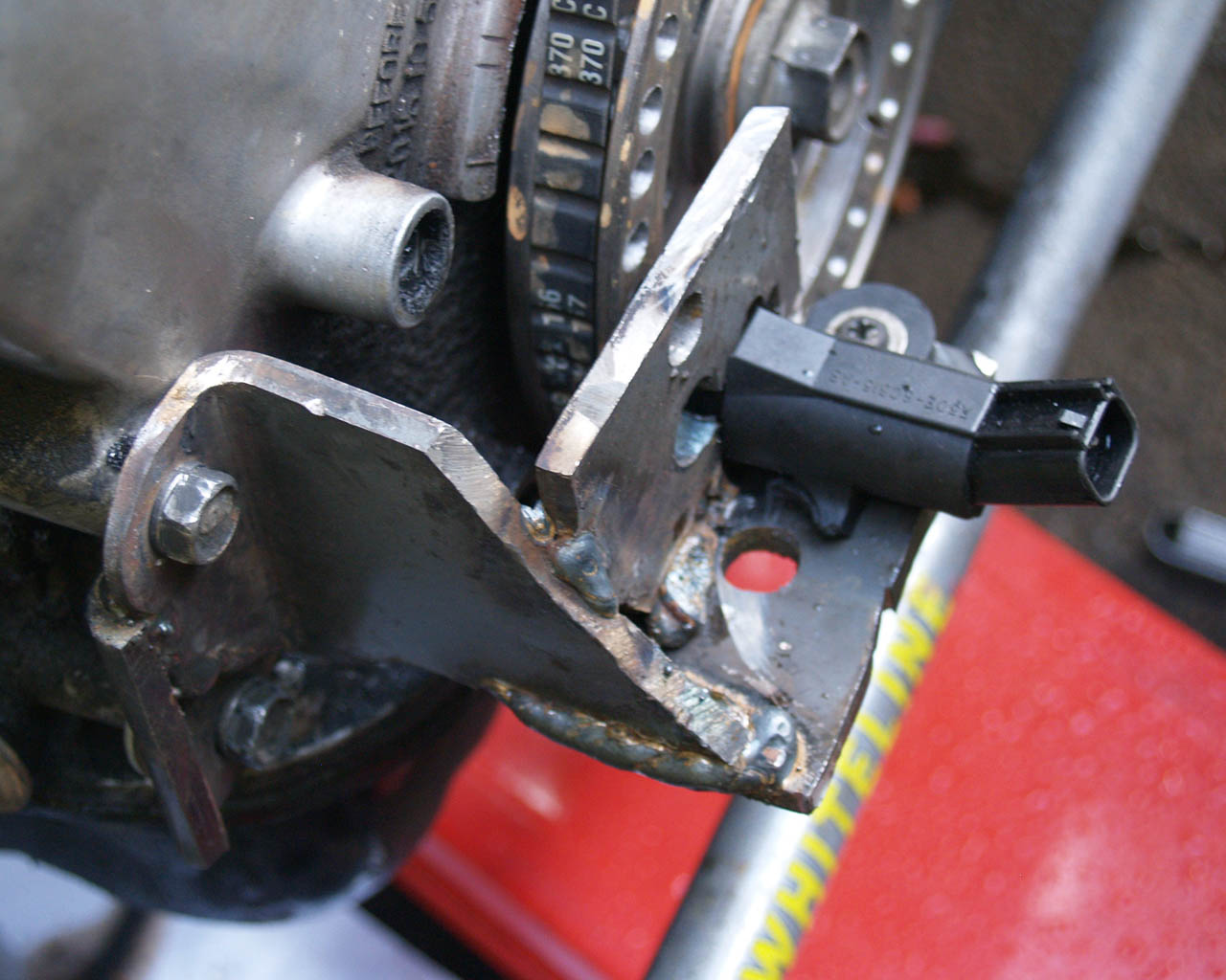

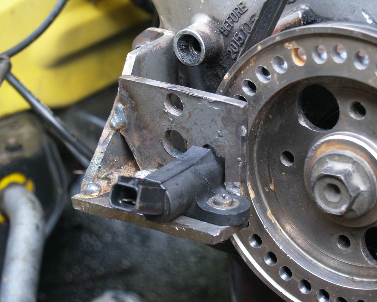

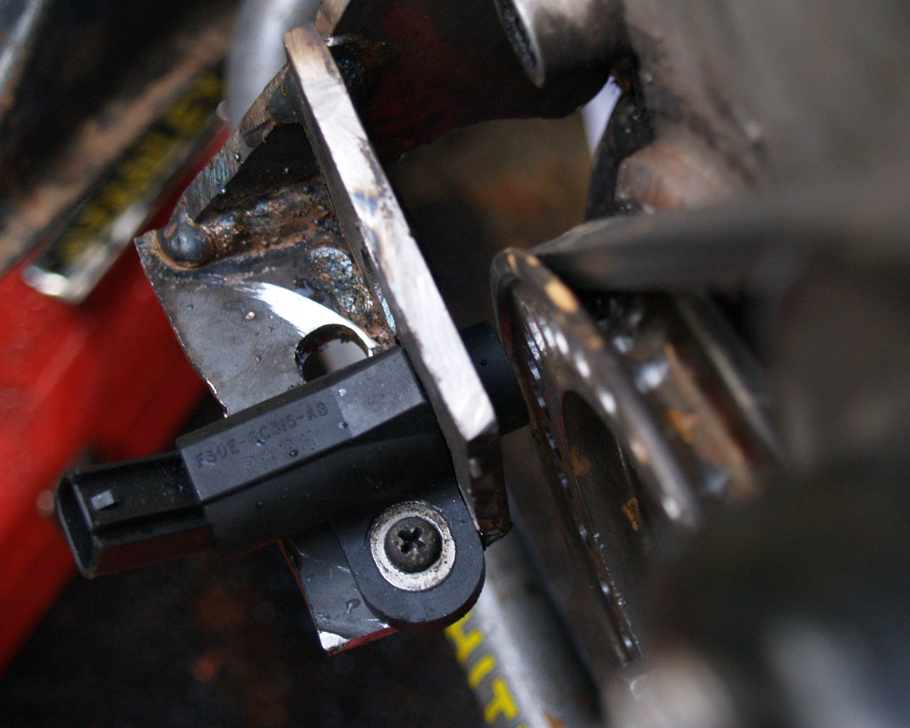

Please dont lynch me for the bracket. Still have a bit of tidying up yet.

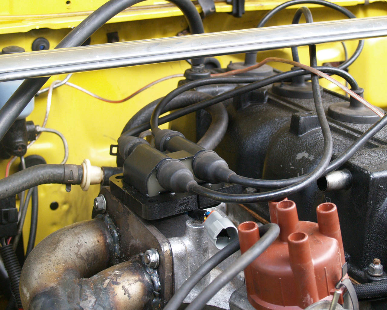

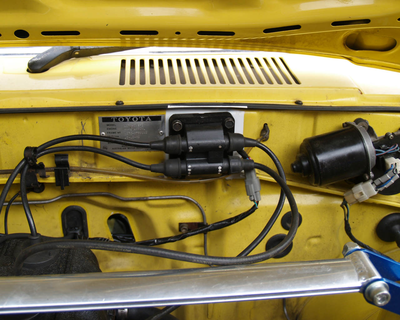

Also the coil i used was for a subaru if anyone cares.

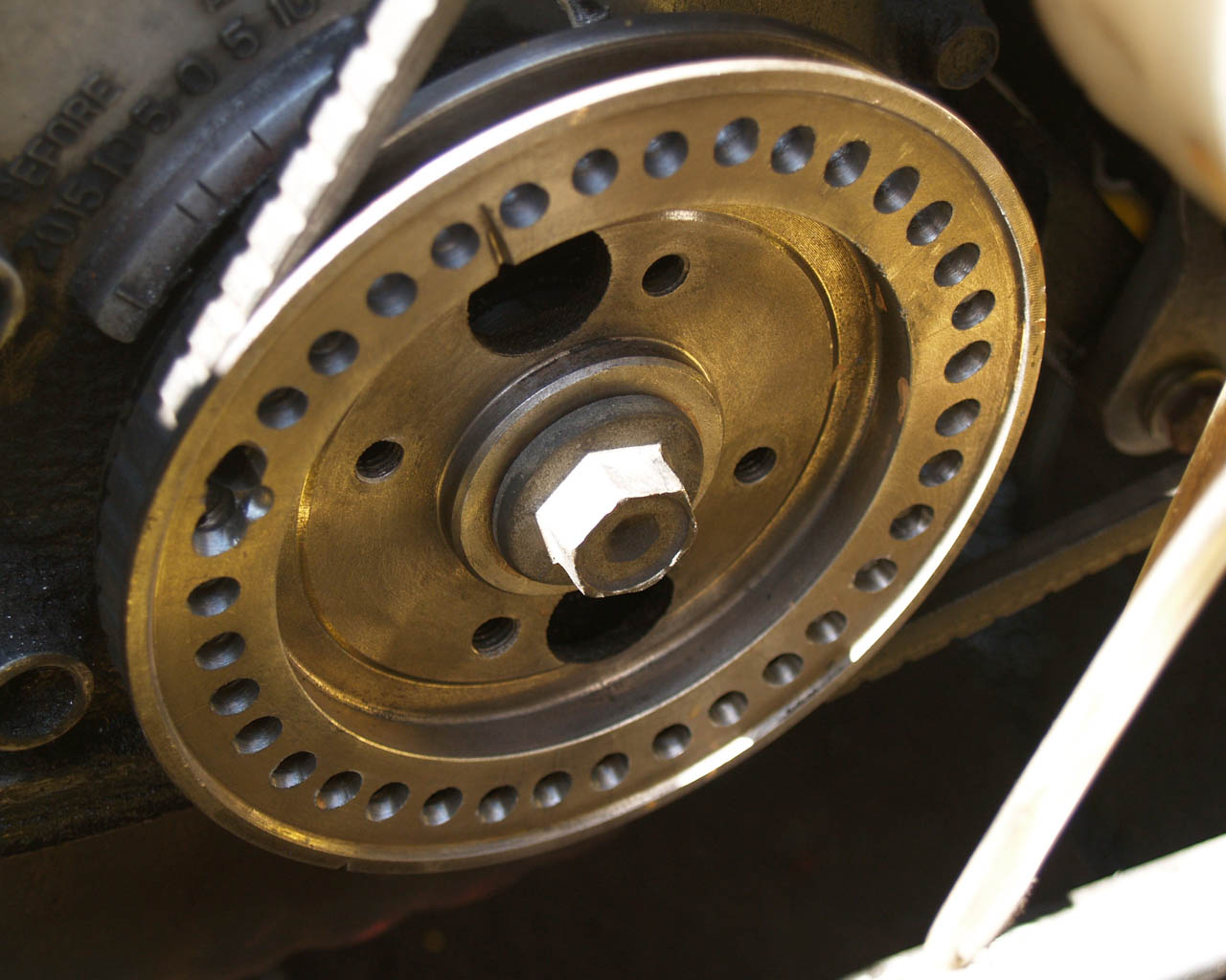

That bracket looks pretty stout! One way to improve it is to triangulate a piece on the inside corner, but small enough to clear the pulley.
The distance between the sensor and pulley face should be a bit closer, if possible. Approximately 1mm is ideal.
Thanks for the write up! Good use of the subaru coil pack.

Got the coilpack and megajolt mounted.
Still some tidying up to do but it runs great.
Also replace the stromberg as it hated the rev limiter.
Is that a Subaru coilpack??
pope101
Posts: 22
Joined: Thu Oct 16, 2008 7:51 am
Post by pope101 »
Yep.
Didn't come with o model number or a year tho :S
