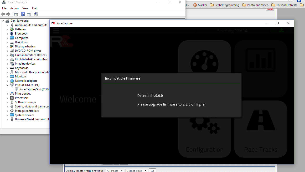

i also randomly get this message.
Hi Danny,
Thanks. So these were logs immediately after trying to do the firmware upgrade. I don't see anything in the logs about it trying to actually do the firmware upgrade process, which is interesting.

Also: the 0.0.0 warning message is harmless and pops up periodically. On our list as well.
