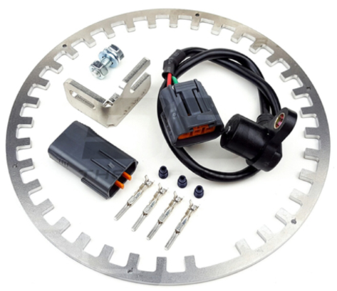

Thanks for the quick reply Brent, I forgot to mention, that I checked the crank sensor gap prior to making that log. The bracket is very short and unlikely to flex. It points to the back of the pulley rather than the edge. (Picture of the hardware below.)

Mystery Solved, turns out the sensor was gapped correctly but the alignment was slightly off, ie too far from the crank axis, so it was only reading the edges of the tooth not the whole tooth. Being a hidden system its really hard to see in there, so I had to take off a bunch of tin-ware to get a good look and make a special 90 degree gapping gauge.
