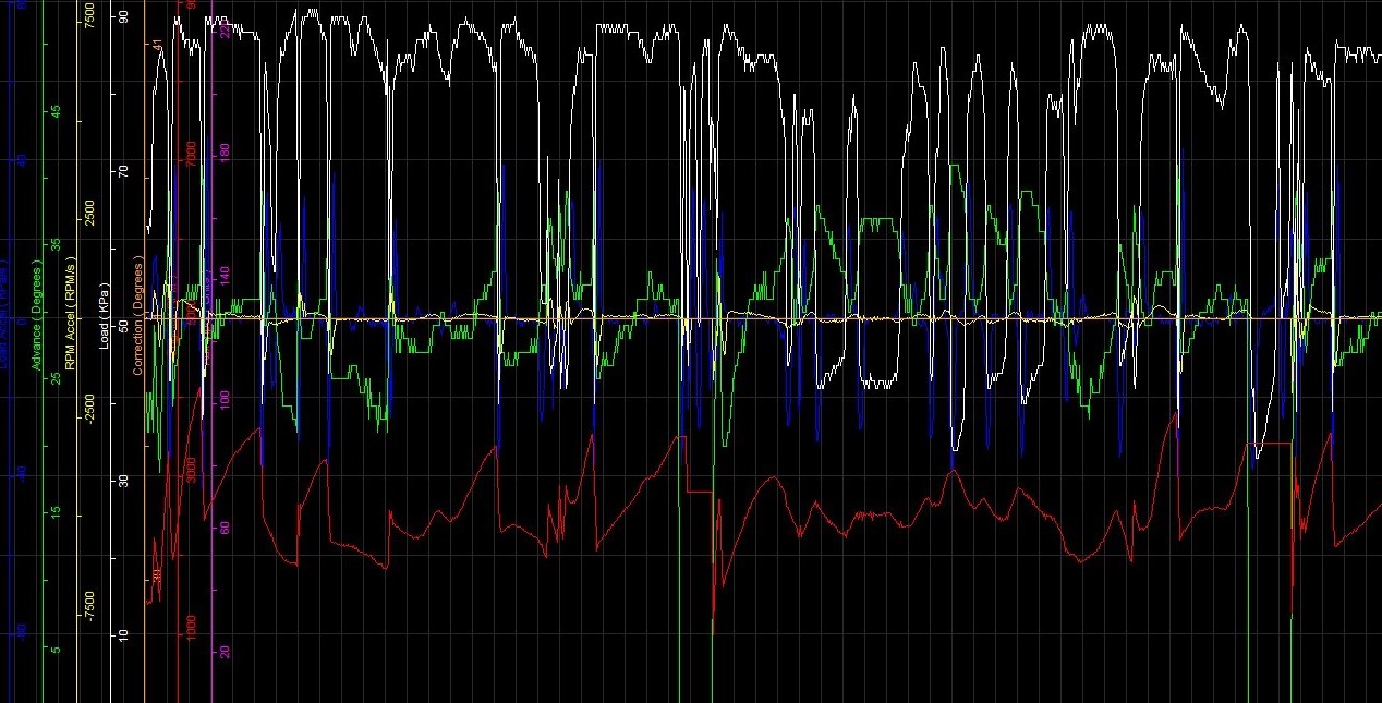

Bringing this post back from the dead. After 5000Km last year with no issues at all, the problem has returned, on the first two drives of the year. I managed to get some runtime data while it occurred this time, two instances on one session.
I've attached a screen shot. The red RPM trace flatlines for a few seconds, the ignition cuts out followed by a loud backfire once it sparks again. The white load trace goes crazy, but that is just my foot blipping the gas to see if its kicked back in. It seems to be worse when the engine is hotter but happens at the same points on the hill leading to my house. The steepest parts. I also noticed my tachometer quits. I haven't seen the tach kick back in as I'm trying to drive, but it isn't at the same time the ignition starts working.
Is this a symptom of a bad sensor wire or connection?

This could be a symptom of the sensor losing sync with the trigger wheel. Make sure the distance is correct (~1mm) and the bracket is very rigid to reduce risk of harmonic vibration. Also, check all wiring.
If you unplug the megajolt and run the engine at the default 10 degree BTDC, you can see if the problem persists. If so, then you'll know it's around the EDIS installation.
