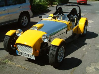

Here's my car, now running under Megajolt (maps still under development). It's built to Ron Champion's 'Locost' design.
It has a 1660cc Ford Kent (crossflow) engine, a weber 32/36 DGV downdraught carb, and a fast road cam.
Keeps me occupied! :P

I wouldn't like to publish my map at the moment - it's only a 2D one, and is still under development. It is a safe starting point however, and is certainly no worse than fitting a racing mechanical distributor without vacuum advance. The MAP range is 20 to 100; advance at 800rpm is 12 degrees, to 36 degrees at max revs (6200rpm).
At the moment I'm trying to make a device for listening for any pre-ignition - as you can see from the picture, when on the move I can't hear the engine itself because of wind noise and exhaust roar! I'll be using a knock sensor, amplifier and noise-reducing headphones so that I can hear the 'pinking' where my development map is too far advanced. This work is still in the very early stages.
