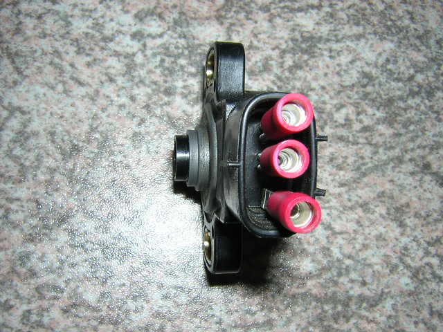

It doesn't move as i thougt it should. It jumps from 0 to 80% with the slightest of pedal movement and then another jump to 100% at full and then sometimes doen't move at all. It looks like a faulty TPS. I assume it ment to flow round from 0 to 100% as i move the pedal

Im running Yamaha Mikuni R1 Bike Carbs, they have a TPS on the side, can someone confim the connections as to whats 5v & earth & TPS trigger to MJ as per picture

Almost certainly the centre connector is the wiper - MJLJ pin 9
Impossible to tell which one is supply (MJLJ pin 6) and which is earth (MJLJ pin 8 or local earth) - one way round will show low% at closed throttle and the other will show high% at closed (you want low% at closed!)
When it's sorted you can do the throttle calibration exercise to make it 0% to 100% on the Configurator and in the MJLJ
If you keep the wiper roughly in the middle you'll come to no harm whichever way round you do the connections
Also use a voltmeter on the centre wiper - should go smoothly low volts to high volts with increasing throttle.

I had a fiddle with a multi meter an laptop, looks like its not broken but fitted wrong, not lined up on the spindle somehow, and wired wrong by me. All sort, it now moves from 0 to 100% as i press the throttle.
Turned out it needs Earth at the top Signal in the middle and 5v at the bottom as per the picture.
